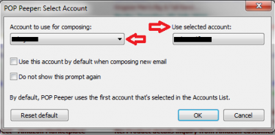

When a compose message is started the following interface window is provided:
The account selected in the account list in the left pane of main PP interface is provided at the top right ('use selected account;') and is utilized by clicking on that button. The alternate option to select any account in the account list is provided to the left in the drop-down list button. I see you have solved the default that displays in that optional drop-down button.

Yep, the problem was that I was not seeing the dialog that's supposed to appear when you compose a new message. Evidently I chose a default account then asked it to never show me the dialog again. Resetting the prompts would undoubtedly fix the issue, but beyond that the only way to reverse the effect appears to be manuallly editing the ini. All good for now, thanks again.
