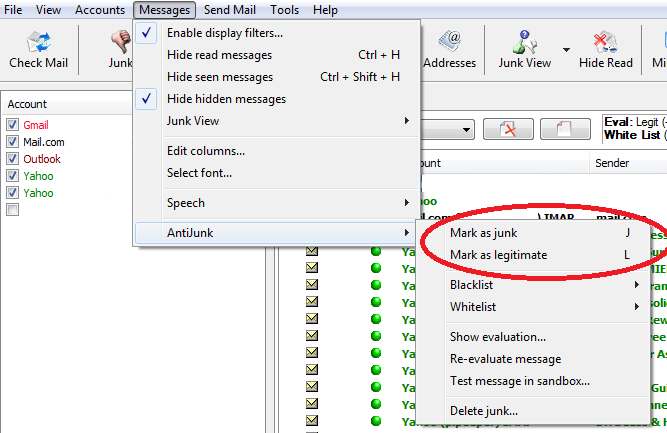

OPTION 2) Use main menu function as illustrated to do the same as the above Option 1.
Mark as "Legit" or "Junk" using main POP Peeper menu.
