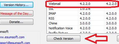

Okay, now that we know this is a Yahoo Account and you are using the "Webmail" protocol and that your "Server Type" is "Yahoo" the next question would be is your webmail plugin version current. This is because v4.2.1 of the Webmail plugin released Jun 27, 2016 was to address Yahoo Updates for both basic and full interfaces to fix header information issues at that time. If you go here: http://www.esumsoft.com/products/pop-peeper/plugins/ and scroll down to the bottom of the page where you will find Webmail plugin information where if you click on "Version History" you will see the Webmail plugin version releases and what each release was for.
Go to POP Peeper "Help" > "About POP Peeper..." and take a look at the Webmail plugin version you currently have.
The current Webmail plugin version is 4.2.3, but you minimally need version 4.2.1 to avoid the issue you currently have.
If you do not have the current Webmail version (if not at least v4.2.1) then to update when you are at "About POP Peeper..." as mentioned above, press the "Check Version" button. This should update the Webmail plugin, keep in mind that you may need to restart POP Peeper for the update to take effect.
Click on "Help" > "About POP Peeper..." to get this window.  Then click on "Check Version" button if you are not current.
Webmail version.png (7.62 KiB) Viewed 3578 times
