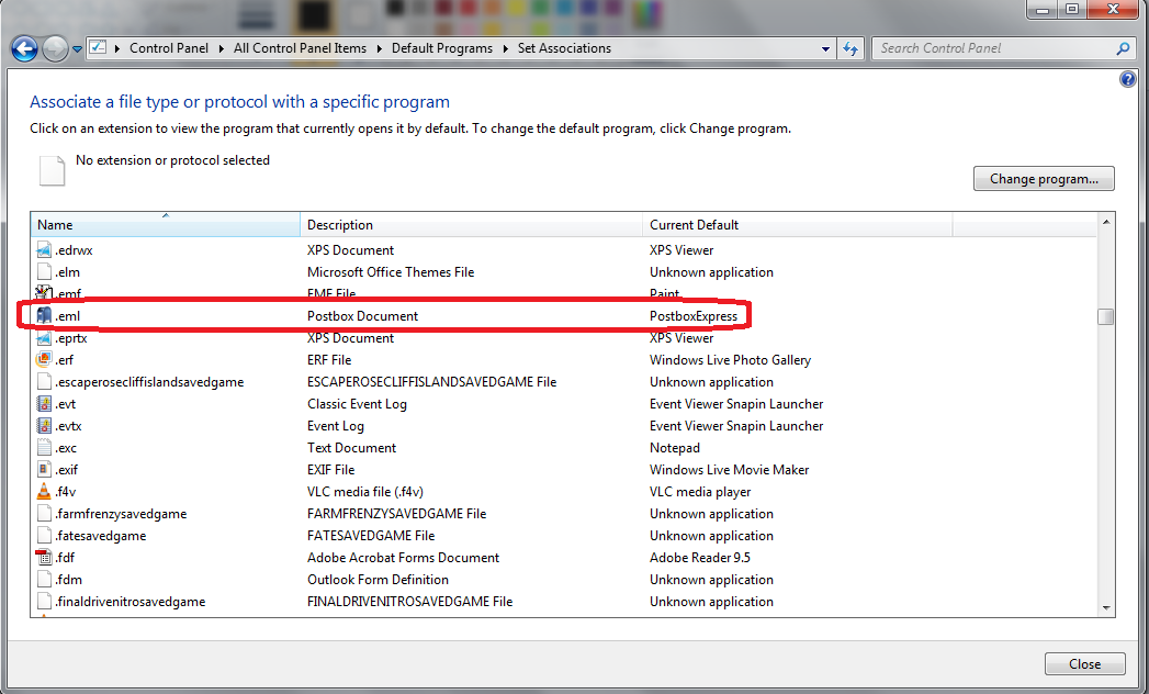

Jeff can better answer all your questions, but I'll just touch on some of what your asking for now as I understand it.
Thunderbird is one of a number of Email Clients that use the .eml extension for their message files (actually .eml belongs to the Microsoft's family of e-mail clients). The reason Thunderbird opens when clicking on the .eml file is because you presumably have Thunderbird set as your default Email Client. Since .eml files are created to comply with the industry RFC 822 standard, they can be used with most e-mail clients, servers and applications (FYI; EML is an acronym for E-mail btw). Any Email Clients you might have that use the .eml file extension for their messages will be associated with the .eml file type (see example below).
Here is an example; One of my Email Clients is Postbox Express (which also happens to be my default Email Client), notice my computer's .eml file type association (click on image to enlarge for better viewing): Presumably in your case your file type association for .eml files is set to Thunderbird and therefore clicking on that file type will open Thunderbird. Of course POP Peeper interfaces with the respective Email Client(s) that are associated with each of the corresponding Email account(s) to produce each of the respective account(s) messages setup in POP Peeper, details on this can be better explained by Jeff.
