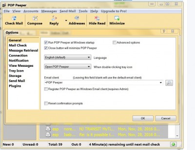

I was able to find how to change email client to PP but now the whole program just freezes and I can't get into any other program on my PC.
I had to do a hard restart to get back in. I have uninstalled PP and reinstalled and the same the same thing happens. The program is not unusable and I can't have it on my PC until I find the problem with it.

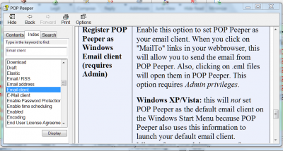

Jeff & other members of the Esumsoft Team should be stopping by this afternoon and can provide more info on the issue you're having. In the interim, if you open PP > {HELP] > [CONTENTS], scroll down the list of topics shown on the left side of the window that opens, and click on "Email client", then click the [DISPLAY] button at the bottom, information will appear in the right side of the window.
Scroll about two-thirds down the page, and you will see information as shown in the screenshot below, which deals with registering PP as your email client, along with some issues that can occur & how to resolve them. Please post back if you are still experiencing problems after trying the instructions given in the Help File article.

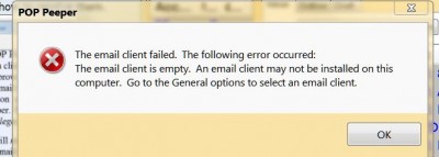

Here's a follow up with the error message I get with PP set as default email client.

When I had asked what you changed, I was actually referring to this comment:
The email client that you're setting there is for an external email client (e.g. Thunderbird, Outlook, etc.). Setting it to "POP Peeper" won't have any beneficial effect. That being said, it made me nervous when I realized that's what you meant and that that's what caused it to freeze so I tried it myself -- I did not have the same behavior that you described, but I'm still curious to know what action you performed that caused PP to freeze at that point (ie. did you press the "email client" button, did you try to compose a new message, etc)?
I do recommend removing "=POP Peeper" as your email client -- just set that value to blank or select a different email client. Since you're getting the "email client is empty" error, I presume that you don't have another email client installed. This is not unusual; and in that case, you should just leave the "email client" field blank.
The screenshots help, now I understand that problem.bbqbrisket wrote:I was able to find how to change email client to PP but now the whole program just freezes
