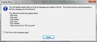

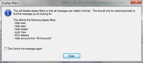

Re: can not access unread messages
Take a look here in main PP interface (under "Messages"):
The top option should be checked, try temporarily disabling "display filters" (uncheck) to see if this helps, you will get the following explanation regarding what this does (click on image to improve readability):
Let us know if doing this makes a difference.Good judgment comes from experience and a lot of that comes from bad judgment. - Will Rogers
If disabling "display filters" does result in showing the messages, the most likely reason would be because the messages are marked as "hidden" (hidden messages will appear in italics when displayed).
When I uncheck "Enable display filter" all messages are shown in the pane except those who I can not reach, those who are problematic from the beginning. For example if an account has total 10 messages, 2 of them are unread, in the pane are shown only 8 messages minus the two ones (previous picture Gmx 1 account)
