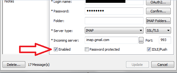

Posts: 2278
Re: I totally fudged my Pop Peeper -HELP-
baconcheddar wrote:
I checked IDLE/Push but not Enabled and Password Protected
One glaring point is that the "Enabled" needs to be checked. Unchecked, the account is disabled.
To illustrate, if you go to "Account" from the PP Main menu and select "Show enabled checkbox" the Accounts List in the left pane will display if accounts are enabled or not based in the check-mark in front if each of the accounts (just for illustrative purposes, typically this column will be disabled and not show). By checking the "Enabled" option the account will be enabled (active) to Check Mail, and you'll then see the check mark appear in this column if you happened to enabled the column.
Check "Enable" for active account
enable account.png (10.75 KiB) Viewed 12085 times

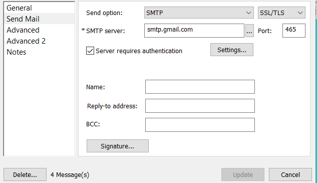

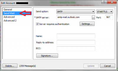

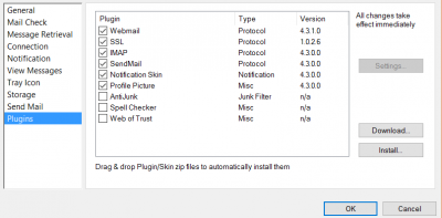

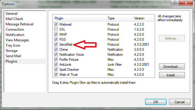

What you want to do at this point is right-click on an account and then select "Edit account..." from the context menu, then select the "Send Mail" tab in the left pane of the next window (see below) where you will then find the "Send option" settings. This setting should be set to "SMTP" if incoming mail (in the "General" tab) is either "IMAP" or "POP3", otherwise it should be set to "Webmail" in this window.

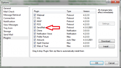

If what you get does not have the same 4 tabs in the left pane as illustrated above, more specifically does not have the "Send Mail" tab then from the main menu go to "Tools" > "Plugins..." and make sure that "Send Mail" is enabled (checked) as pointed out in the screen-shot below.
If the plugin is checked and you do not have this "Send Mail" tab as pointed out in the first screenshot, then please post a screenshot of what you are getting (make sure and redact the email address, as I did, at top of screen-shot).
Also, assuming you do have the "SendMail plugin listed and it is checked (enabled) then make sure that its "Version" matches your version of POP Peeper (ie. v4.3.0.0) Note: If "SendMail" is either not listed or is old, then you need to re-install POP Peeper and make sure that "SendMail" is enabled (selected) in the "Choose Components" page during installation (the checkbox should be ticked). Note: If re-installing, do not uninstall (simply install over PP).

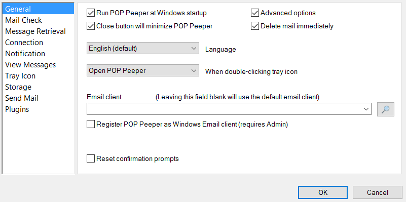

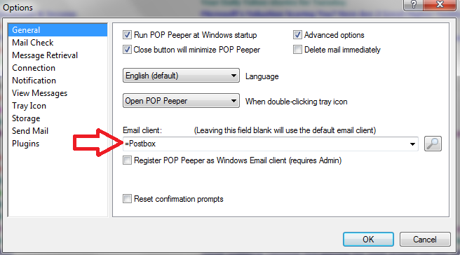

One last thing, what do you have in the option pointed out below ("Tools" > "Options" > "General" tab)?
If you have a value that represents an Email Client that you do not have installed then that can pose a problem. If the problem persists and you have a value here, you could try leaving this option blank (doing so will result in your system default Email Client being used).

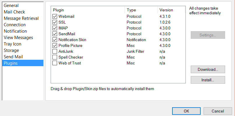

Good thing I learned to screen-capture a few days ago! Very useful 8)
So far so good in receiving emails.
I seem to have all the requirements:
Of course, If I leave the email client blank, I get the pop-up saying that I have to write one. I only know Gmail or Hotmail but I don't want to be directed to them to write stuff. I want to compose on PP, just like I used to less than 72 hours ago! :x

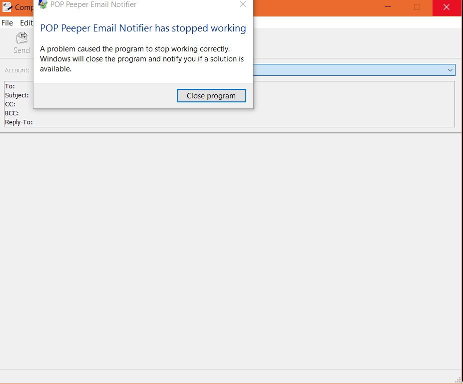

Also, let's say I choose a contact in the PP address book, the account dropdown will be empty where before, it had my 5 accounts to choose from. I even had a pop-up telling to preset one for future emails. If I choose one account to write from, I will automatically get this pop-up:
It will then "force-close" PP and I'll have to click on the Start button to have it back in the taskbar.

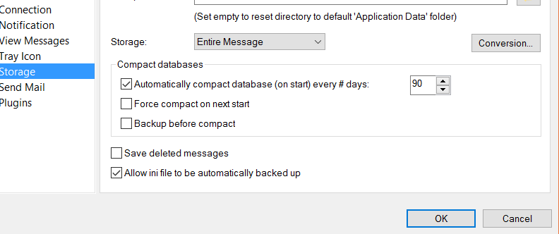

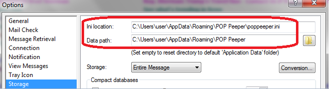

Before we go there, please provide us with a screen-shot of your storage settings under "Tools" > "Options", select "Storage" tab. Thanks.

lakrsrool wrote:Your PP send mail is functioning very oddly of which I'm suspicious of possible corruption. :(
Gaaaah! Not the (other) c-word! :shock:
Here:

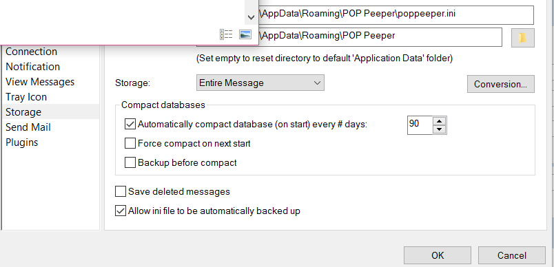

lakrsrool wrote:... please provide us with a screen-shot of your storage settings under "Tools" > "Options", select "Storage" tab. Thanks.
My mistake for not clarifying better, was expecting to see entire window as the more pertinent info is in the upper portion (which should look similar to what is circled):
But that's okay, no need now that Jeff is requesting info via email. :wink:
My mistake for not clarifying better, was expecting to see entire window as the more pertinent info is in the upper portion (which should look similar to what is circled): upper part of storage settings.png But that's okay, no need now that Jeff is requesting info via email. :wink:
I've hidden some personal info but it's pretty much the same strings in both fields:
