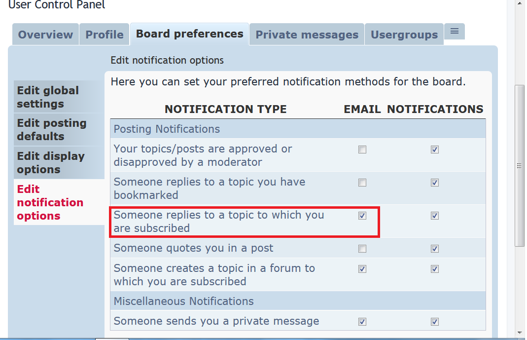

Two other things you can check are: (1) - look in your User Control Panel > Board preferences > Edit Notification Options, and see if what is displayed there matches what is shown within the red rectangle in the screenshot below:
Editing Board Notification Options for topic replies
(Click image to enlarge)
If the box for email notification is not ticked, try check-marking it, then click the [SUBMIT] button at the bottom right of the page. Next, log-out of the Forums, then log back in, and continue with whatever activity you were doing.
After logging-out of the Forums again, just monitor your email account (the one you have designated to receive email notifications from the Board at) for a while.
Let us know if you finally begin receiving notifications of replies to topics you have subscribed to. (Remembering what lakrsrool mentioned, i.e. the Board will only send you 1 notification of any replies, until you log-in to the Forums again).

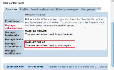

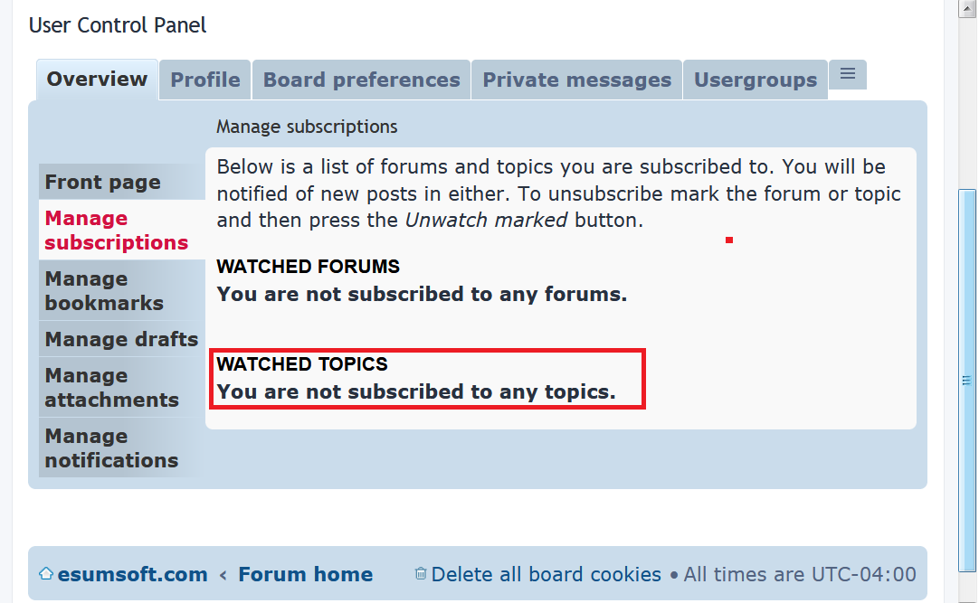

And, (2) - in your User Control Panel > Overview > Manage subscriptions,
look to see if the topics you are subscribed to are being shown there. (See the red rectangle in the screenshot below. NOTE: in the image I posted, I'm not subscribed to any topics, so it shows that fact).
Verifying topics you are subscribed to via the User Control Panel
If you do not see any of the topics you are subscribed to, let us know this also.
