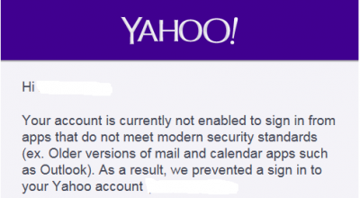

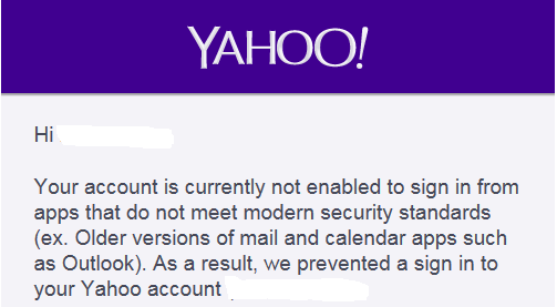

After receiving the above error for 3 days Yahoo sent me an email which said I can't SEND from my account from login apps that don't live up to modern security standards !!! ??? You can perhaps check what they mean and make some adjustments in PP which I have used for many years :)

andromeda wrote:..... Yahoo sent me an email which said I can't SEND from my account from login apps that don't live up to modern security standards !!! ??? You can perhaps check what they mean and make some adjustments in PP which I have used for many years :)
In case you were not aware, instead of using the "Yahoo" (WebMail) setting for your "Server type" you have another alternate option to use "IMAP" along with oAuth2 which by using this combination of settings you would not see these type of messages from Yahoo anymore, that is unless there is some reason you are unable to use IMAP.
If you would be interested in trying "IMAP" then the steps to switch to this protocol would be the following:
1) Edit the Yahoo account (right-click on account and select "Edit account...").
2) Change the accounts "Server type" from "Yahoo" to "IMAP" from the drop-down selection list.
3) Then click on the "oAuth2" button and follow each step to enable this function.
4) Press the "Update" button to save your changes.
Keep in mind that the first Mail Check (only) will take longer after making this change as PP switches over to the changed protocol. :wink:

Good to know and and thanks for your input - I'll certainly try it if PP's team can't tweak PP so that it comes up to Yahoo's standards !!! as I realise they are trying to protect the public. Like jdbliss, I too can send from within Yahoo and will continue to do so temporarily. :D
Posts: 9421
Re: Sending stopped working-yahoo
Andromeda -- to be clear, the use of IMAP with OAuth2 *IS* the security standard that Yahoo is referring you to. In fact, POP Peeper is ahead of the game because the latest version of Thunderbird (v52.0) still does not support OAuth2 for Yahoo.
So, if you want to meet Yahoo standards, you need to edit the account and switch the "server type" to IMAP and then press the OAuth2 button and follow its instructions. In fact, using IMAP is recommended over WebMail (ie. server type = "Yahoo").
The specific issue regarding the -60 error with WebMail is still being investigated, but there are multiple reasons for a -60 error. That is, the specific reason for jdbliss' issue seems a little unusual and may not be the same reason you have a problem.
