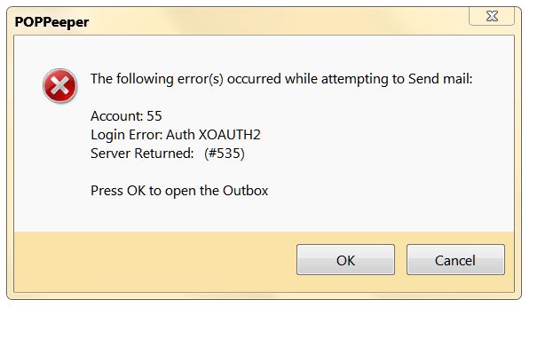

I am constantly getting this error no matter how many times I change from POP3 to IMAP, or Hotmail/Outlook and then back again to any of the others.
It is happening on about 3 to 4 of my 7 hotmail accounts. Interesting that it is not on all of them.
XOAUTH2 Error

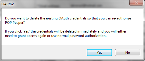

Alternatively if the problem persists you could try using IMAP with one of these problem accounts and click on the "OAuth2" button and if you get the steps to enable "OAuth2" to authorize POP Peeper follow the steps to do so and test account. On the other hand if you get: click "YES" to delete the credentials and then click on the "OAuth2" button again to re-authorize by following the requested steps and then test the account once again.

and then test the account to see if the problem is solved.Alternatively if the problem persists you could try using IMAP with one of these problem accounts and click on the "OAuth2" button and if you get the steps to enable "OAuth2" to authorize POP Peeper follow the steps to do so and test account. On the other hand if you get: click "YES" to delete the credentials and then click on the "OAuth2" button again to re-authorize by following the requested steps and then test the account once again.

Are you getting the same error as before? If not please post the error(s).

Error 535 generally indicates that the login failed. If you've reset the OAuth2 credentials per lakrsrool suggestion above, then I suspect the issue is with Hotmail's servers. They're already known to have serious issues with Imap, and also with POP3 (albeit to a lesser degree), so it stands to reason that SMTP has issues, too; although I haven't done any testing with smtp myself.
I just sent myself a test message. The imap account was currently busy for a while having the normal issues, but once it finished, the smtp connection went off without a hitch. I sent myself another test message while nothing else was happening and it seems to react quickly. So it's possible that smtp isn't affected by the problems (2 messages is not exactly scientific proof).
