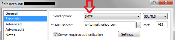

For those that prefer to use "Webmail" (instead of the recommended "IMAP"), changing the Send Mail "Send option" from the existing default "Webmail" setting to "SMTP" (refer to screen-shot) fixes this "send" problem for those using the "Yahoo" (Webmail) "Server type" (for incoming): This approach is what resolves similar "send" errors for MSN accounts using Webmail "Server type" ("Hotmail/Outlook") as well.
