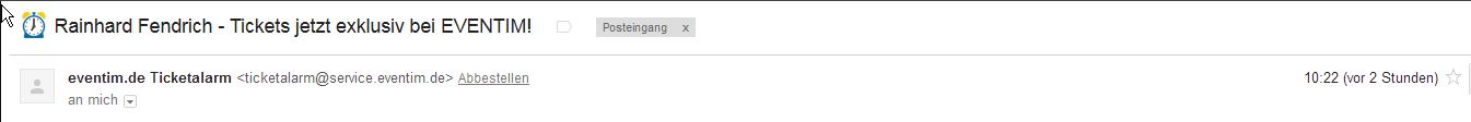

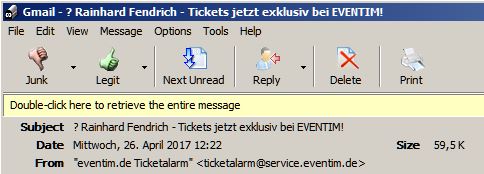

See the attached screenshots from Firefox and Poppeeper that show the different time
Poppeeper showing 12:22
Firfox Gmail showing 10:22

Her the images once more:
Gmail showing 10:22
Gmail showing 10:22

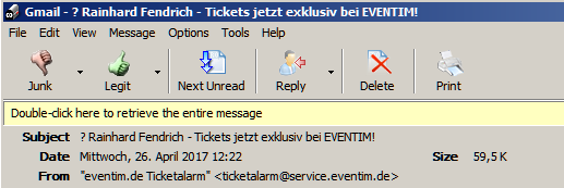

FIREFOX with GMAIL
2017-04-26 12_40_09-Rainhard Fendrich - Tickets jetzt exklusiv bei EVENTIM!.jpg
POP PEEPER with same email
2017-04-26 12_39_30-Gmail - _ Rainhard Fendrich - Tickets jetzt exklusiv bei EVENTIM!.jpg

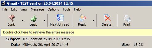

Here another Image
I sent a testmail on 12:45 26.04.2017 to my account.
see which time is displayed in PP

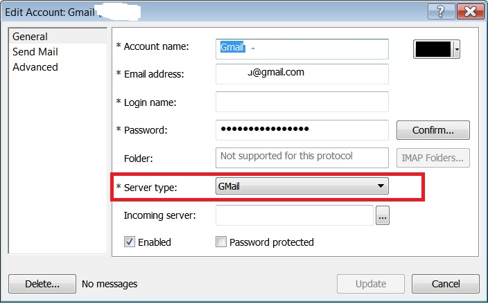

The information can be found by doing the following:
1. Right-click the account in the Account List on the left side of the main POP Peeper interface.
2. Click on "Edit account" in the menu displayed.
3. On the next page displayed, look at what is shown beside "Server type". (The information needed is displayed in the red rectangle in the screen image pasted below).
Location of the "Server type" for an email account in POP Peeper
(Yours may show Gmail, POP3, or IMAP).

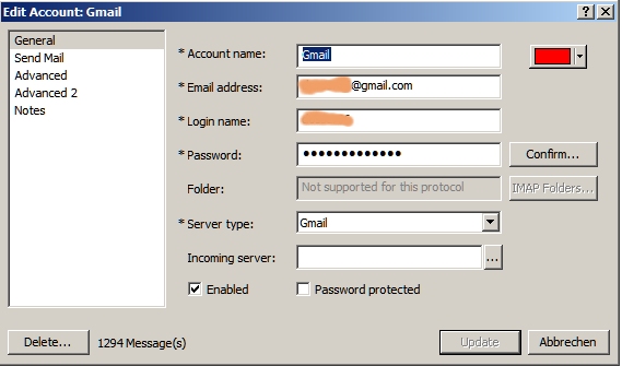

Her the screenshot of the account config for gmail
Re: Wrong Time in PP

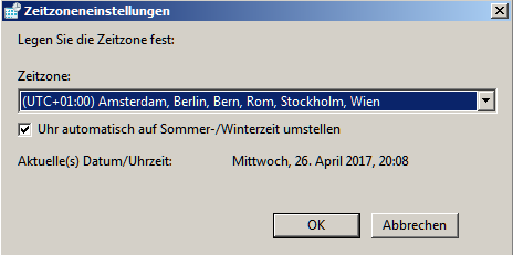

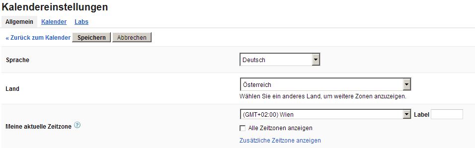

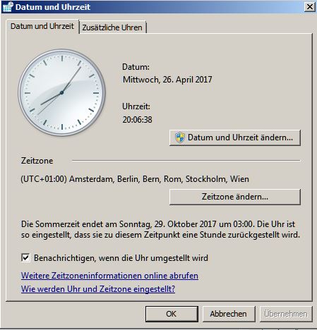

There is nothing to change:
see screenshots:
2017-04-26 20_08_10-Zeitzoneneinstellungen.png (9.37 KiB) Viewed 10546 times
As the Computer is part of a Domain there is no "Internet Time" tab.

dosser wrote: As the Computer is part of a Domain there is no "Internet Time" tab.
Okay, this could be causing your problem (which you would want to check out instead of trying the above "IMAP" change. I was posting the above at the same time you were posting so didn't know this at the time). In fact you may not be able to even use IMAP at your work-place, I am presuming this is occurring at your work-place, right? (I'll bet this issue does not occur on your home computer, have you tested for this time-stamp issue at home?).
Here is the possible problem: Any domain-joined computers pull the time from the domain controllers by default. And in these cases, if somebody changes those settings this could possibly create these kinds of issues.
When you are logging into your computer at work have you ever noticed a message similar to this "There is a time difference between the client and server."?
If so then this is because the clock on your computer that you are logging into is reporting a different time than what the time is set at on your domain controller.
You can refer to this web page for more details about this: Windows Domain Time Issues.
(LINK: http://rumkin.com/reference/problems/time_diff.php)
Posts: 9444
Note (mostly to self): The timezone specified in your gmail account is gmt+2 and your PC is gmt+1. This corresponds to my own account where gmail shows -0600 and PC shows -0700. PC has a difference of -0100 from gmail in both cases (DST).
