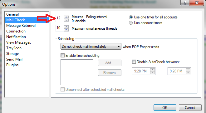

To answer your question, YES absolutely!! (as far as account log-in frequency as opposed to Server usage) - if I understand you correctly you are checking mail every minute (see screen-shot below). If you have the Polling Interval (pointed out below) set to "1" this would clearly create a problem since this would be logging into you accounts far to frequently. Some Email Clients would actually shut down the account (i.e. Yahoo and others) temporarily if this were done, so I'm not surprised that you would be having problems.
We have had issues in the past with some Email Clients having problems with even the Mail Check interval value set to less than 15 minutes.
I have mine set to "12" (as you can see in the screen-shot).
Also, since you are using IMAP, it would definitely be better to use "IDLE" by enabling (check) "IDLE/Push" in the Account Edit interface (General tab). This way your accounts will not be doing a log-in as much since IDLE remains logged-in for longer periods of time and doesn't have to log-in all the time behind the scenes. But more importantly than that since Mail.com supports "IDLE", you will get your messages as soon they arrive on your account(s) Servers. With this in mind it is not necessary for these accounts to be doing interval Mail Checks that often because with IMAP account that use IDLE you receive messages right away regardless of the Mail Check settings.
We generally recommend setting all IMAP accounts to use IDLE and set Mail Check Interval to 10 minutes or more.
I have mine set to 12 minute intervals.
Btw, eyecandy - you can test this yourself, change the Mail Check Interval to say 10 or 15 and while the Mail Check is waiting until the next Mail Check (look at Mail Check status in status bar of main PP interface or if you have the "Minutes until next mail check" option enabled just hover over the system tray icon to get this info) and send a message to these accounts with "IDLE" enabled to test what I have described above, you will see that the messages will arrive in the POP Peeper inbox for these accounts within a few seconds of sending the messages and that a Mail Check was not necessary for PP to retrieve them. Pretty neat, huh? :wink: (so you can see your concern about getting messages quickly is addressed by using "IDLE" for IMAP accounts in this case and it is not necessary for the Polling Interval to be such a low number that would cause such frequent scheduled Mail Checks, all of which should help resolve your issues with Mail.com accounts and at the same time more pragmatically serve your intentions of having one minute polling intervals to retrieve messages in a timely manner.)
