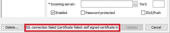

  1. The error message for this issue is cut off in the relevant account's settings:
    Cut off message
    Cut off message

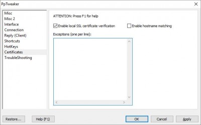

  2. PpTweaker has no help for:
    1. What will happen if I turn off "Enable local SSL certificate verification". Will it use a remote verification? If not, maybe it should be rephrased to "Enable (local) SSL certificate verification".
    2. Should I turn on "Enable hostname matching"? Is there any benefit?

lwc -- The error displayed in the account is not intended to be the primary reference for errors. Press the yellow '!' button on the status bar or File/Error-overview from the main menu.

If you disable local SSL certificate verification, then PP won't do any checks. It's not as secure.
"Hostname matching" is another step up in security. I would recommend enabling it, and if you have any errors, deal with them.
It was a tough choice, but I decided to disable this feature by default because I knew it would cause even more issues on top of the certificate-verification option. I think that the faq explains the potential issues and how to fix it, but let me know if you run into any problems and/or if you think that the faq can be improved.

It does...? If you press F1, it opens the help which -- in its entirety -- is:
PpTweaker: Certificates
Please refer to the following FAQ for the most up-to-date information regarding SSL certificate verification:
http://www.esumsoft.com/products/pop-pe ... ?q=sslcert

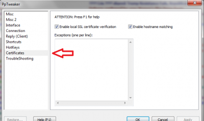

Posts: 2275
Re: SSL issues after 4.4
lwc wrote: When I click help inside PpTweaker I just get PP's general help, not the online FAQ.
In the PPtweaker interface window select "Certificates" and then press F1 or the "Help (F1)" button.
This will open the Help page where in the case of "Certificates" there is a link to FAQ for this specific help topic. Other tab selections will be directed toward the relevant Help page for the tab selected when pressing F1 or the "Help (F1)" button.
In regards to the "Certificates" tab this is what Jeff was posting of which the bottom part (in quotes) is specifically what you will see on the "Certificates" help page:
lwc wrote:Maybe make PpTweaker's help link to the FAQ like you said.
Jeff wrote: It does...? If you press F1, it opens the help which -- in its entirety -- is:
