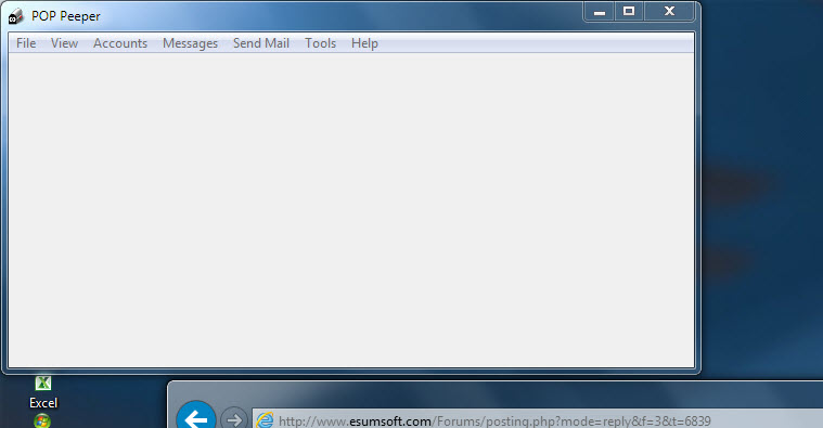

I am a registered user of PopPeeper Pro + Pro Pack. All was well up to version 4.3 which fortunately I performed a backup not to long ago. Updated to the new v4.4. After initial install, clicked the run now button. Received a windows notice that poppeeper is not responding and crashed. Restarted Win7 Pro 64 machine and noticed tray icon. Right clicked check mail and noticed no movement in the tray icon. Double clicked icon and rather than usual program opening in center of screen with accounts and email, it was in upper left corner with partial screen. Clicked on the exit close button and heard windows "ding" and poppeeper remains open. Had to cntl+alt+del to force close poppeeper. Tried reinstall and same situation. Tried compatability settings of prev Win versions and run as admin, did not fix. The new version will not properly execute on my desktop.

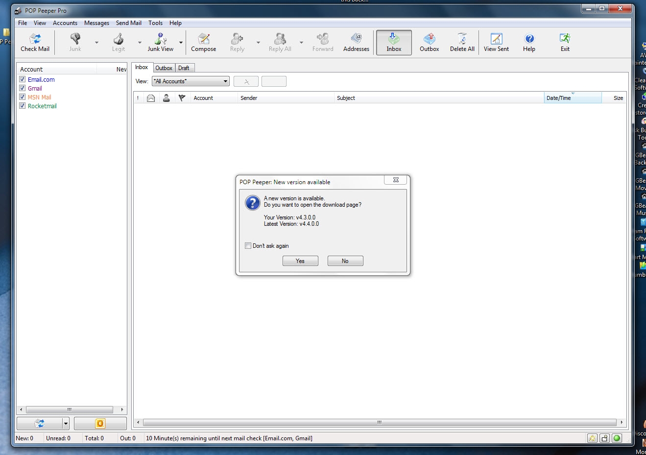

I installed by following the program notification of new version. Which took me to a download page to download 4.4.

Checked and your announcement link took me to same page under the download tab

Tried it for 4th time. Plz see attached screenshot. Top menu bar is greyed out. After 5 minutes, no hard drive light flashing. Task Manager shows nothing currently running. Processes shows 1 pop peeper file .

I think that I might know what the problem might be?? There are no data files in the user name/appdata/roaming/poppeeper folder. All of my account are in C:\Program Files (x86)\Poppeeper\data. All 4 of my email accounts are there as this is what I chose at the backup/restore path. Removed all 4 data files from 4 email folders and restarted pop peeper. It said "you have mail" opened popeeper and still in upper left corner but this time the menus are not greyed out but are still non-functional with the windows "ding"

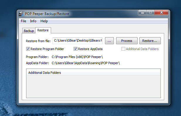

There are only 16 small emails. Attached are screenshots of my backup and restore paths. I think that the new version might not be finding what it is looking for.

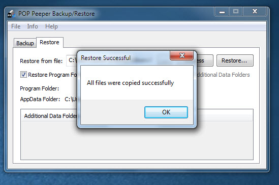

After successful restore to prev version, CPU for pop peeper at Zero usage.

How do I send you the backup file folder? Last one was from 6mths ago with no changes to accounts or settings.
