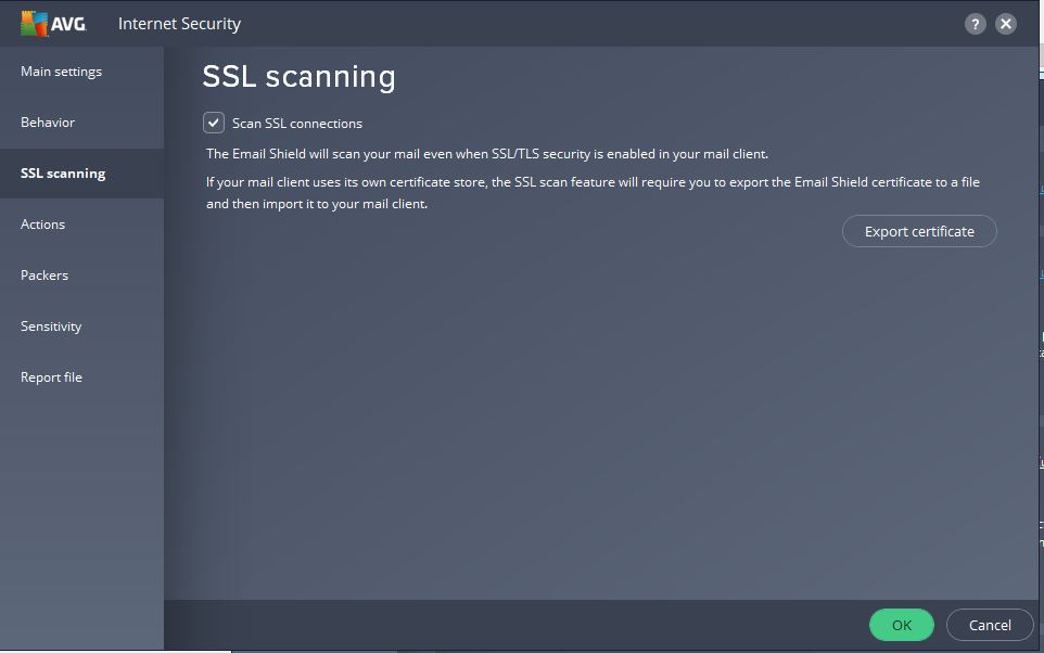

I have the same issue
But I found the the problem lied with my antivirus - AVG Internet Security 18.6.3066
I found that if I disable and re-enable it, it works fine, until I restart Pop Peeper, then the problem reoccurs

Re: Problems with gmail the last few days...
Thanks Pete
I have an update
I found that if you disable the SSL scanning in the "Email Shield" component of AVG it begins to work.
and afterwards you can enable it again and Gmail will still work, until you restart Pop Peeper again
Hi mjaafar - have you tried the suggestion previously posted by Jeff in this same topic?
You can click HERE to go DIRECTLY to that post (if you do not want to disable SSL scanning then try option #2 to import the certificate so that PP can use it.
(Note: I personally use Avast! -- but I can assure you that the SSL scanning interface that I have in Avast is virtually the same as what you posted above [same setting as well] -- so either of the options previously posted by Jeff should presumably work equally well for AVG users

In case anyone tried method #2 (importing the SSL certificate) and it still did not work, please see the updated information:
viewtopic.php?f=2&t=7171&p=36360#p36346
If you have already imported the certificate, then you only need to complete steps 2c-2f
