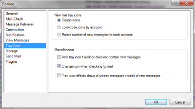

Are these your settings in the PP Tray Icon window? ("Tools" > "Options", "Tray Icon" tab):

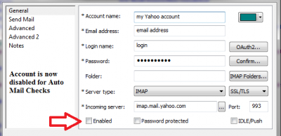

So all is good, but I do have a question, when in the edit account mode and in the general window, on the bottom there is 'enabled' 'password protected' and then the 'IDLE/push... what is checked there is 'enabled' and 'idle/push' what is the enabled check box for and or do??

garalare wrote:.... but I do have a question, when in the edit account mode and in the general window, on the bottom there is 'enabled' 'password protected' and then the 'IDLE/push... what is checked there is 'enabled' and 'idle/push' what is the enabled check box for and or do??
The "Enabled" check box at the lower-left of the Edit account interface enables (checked) or disables (unchecked) the account for doing Auto Checks ("Polling interval" scheduled Mail Checks) on that specific account. If you uncheck this box then when the Auto Check occurs the account will be skipped (not have an Auto Check done).
For example, if you go to "Accounts" and click on "Show enabled checkbox" to enable this option from the main POP Peeper menu you will see check marks in front of all the accounts in the left account pane that have this "Enabled" box checked for each account and if the "Enabled box is unchecked then there will be no check which would mean this account is not "Enabled" and will not do an Auto Check when the "Polling interval" scheduled Mail Check occurs.
For example:
Account is now disabled (Auto check will not be done for this account)

Account does not have check mark (in the "enabled checkbox" column of main interface) when account is disabled for Auto Checks (if you check this box here in this column to enable the account then the check box in the Edit account interface, illustrated above, will then be checked again as well and the account will be enabled for Auto check)
