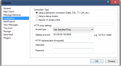

due to difficulties with access to some mail-sites i have to use proxy. i have proxy in browser set for specific domains and tried to make PP to use proxy too = in Connection set Use Specific Proxy and stated address with port that works in browser. this gives no result. tried all 3 option of internet connection one by one - no effect too. what i do wrong?
i can't set proxy for whole system, bad solution, so really need to specifically set PP. i use v4.2 if that makes difference.

In "Tools" > "Options" > "Connection" tab, have you set the "Access type" to "Use Specified Proxy" and set the "Address and Port" to the Proxy address separated by a colon ":" with no spaces? (i.e. 127.0.0.1:4480)
Note: If your proxy requires HTTP Authentication then you should also enter your username and password as well.

yes, i did everything, no effect.
