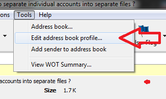

I'm confused as to what you want to do regarding replying to messages from your five email accounts, but in regards to Picture Profile there are steps outlined below regarding this procedure:
1) Open a message in POP Peeper (read a message by double-clicking on message in main PP interface)
2) Within the read message interface click on "Tools" > "Edit address book profile..."

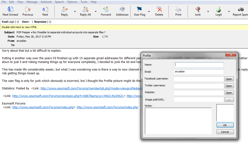

You will see this interface where you can set the account to be identified by a picture when you read the account messages
As illustrated by this example message (note: the picture profile for this account in screen-shot):
