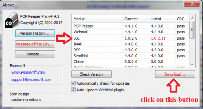

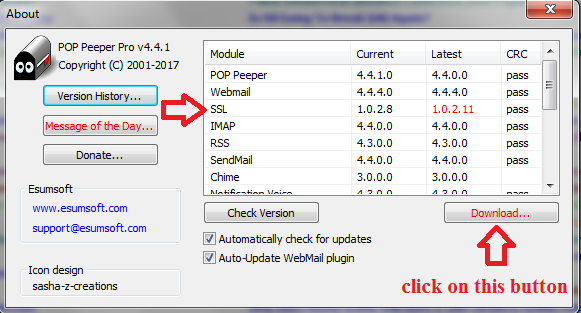

baconcheddar, it occurred to me perhaps a step by step procedure regarding SSL plugin update would be easier to recall (keep in mind you only need to do this if the SSL plugin is listed as needing an update, as illustrated below in the first screen-shot).
Here are the steps:
1) An update is only needed when you see the following (latest in red not matching "current"):

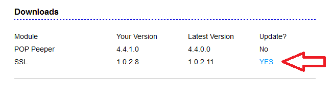

At that time just click on the "Download..." button which will take you to the POP Peeper update page as illustrated (in part) below:
SSL plugin needs update - part 2.png (4.28 KiB) Viewed 3392 times

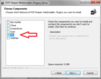

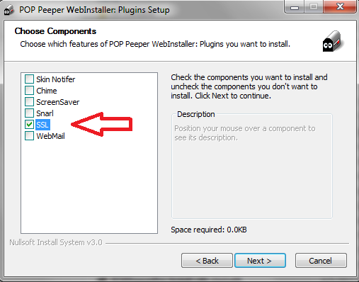

As you can see SSL is listed as needing an update so simply Click on "YES" to download installer. Then by double-clicking on the installer you will get a Choose Components interface where you simply select the "SSL" plugin and click "Next" button to continue to update the SSL plugin (as illustrated below):

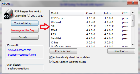

All done, you will now see the following in "Help" > "About POP Peeper...":
