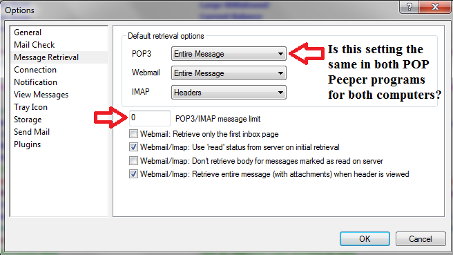

To clarify your reply, please confirm these settings for us from the main POP Peeper interface: "Tools" > "Options", "Message Retrieval":
Are the settings here the same in both computers?

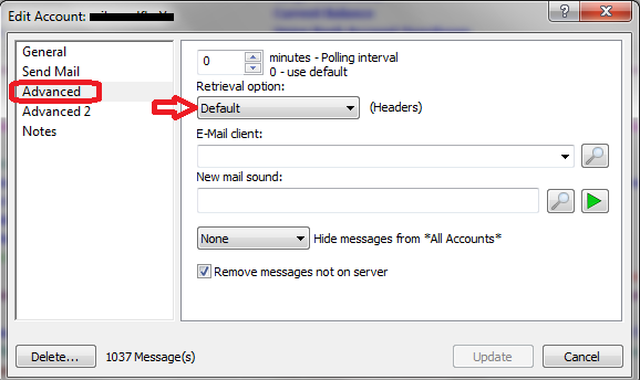

Doing a right-click on the account with the "read" status problem and then clicking on "Advanced" (if you do not see "Advanced" then go to "Tools" > "Options" > "General" tab and enable "Advanced options"). What do you see different than the setting pointed out.

Both computers are set the same and as shown.
