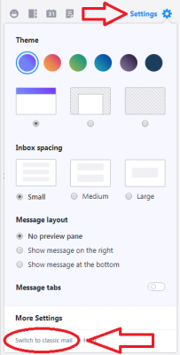

I switched one of my Yahoo accounts from "classic" mode to the "new Yahoo mail" to test in POP Peeper and did not have any problems with POP Peeper for that account.
What you could do is try returning one of these two accounts back to "classic" mode to see if this fixes the problem with that account. That would also helps us to determine if there is a random issue with the "new Yahoo mail" in some cases (I know I certainly did have issues trying to use a browser other than the browser that Yahoo requires to use the "new Yahoo mail" (which would exclusively be Firefox, Chrome or Internet Explorer according the message I got from Yahoo or else the "new Yahoo mail" cannot be used #-o amazingly enough).
You can log-in to one of the two Yahoo accounts that you switched to "new Yahoo mail" and switch it back to "classic" mail by doing the following (to see if this makes a difference):
Click on the Settings Gear in upper right corner then click on "Switch to classic mail" and then test this account in POP Peeper to see if this resolves your error for this account.
Please report back with your results.
