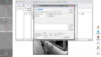

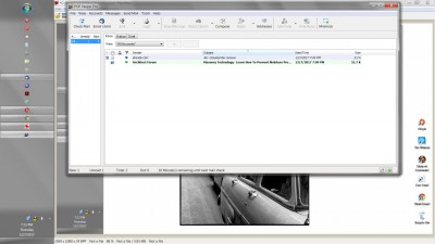

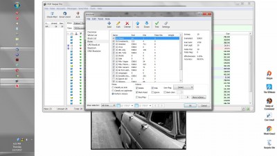

One of my new rules is not working entirely - part of it works but not an important part. The part that doesn't work is "Hiding" the email so I never see it. Please refer to the attachments. The email I don't want to see anymore is from "Weiss". (I've tried to unsubscribe several times to no avail). As you can see, it's got a red dot by it and the trash can but I don't want to even see this, not just tag it. As you can see, I have designated three actions - Delete, Mark Read and Hide. The "hide" part is obviously not working. The text on this is italic in the PopPeeper window which is not normal - I don't know if that makes any difference.
How can I get the "Hide" part of this to work?
Thanks,

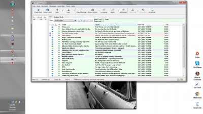

I'm seeing "hide" is not working in my other new rule either. See attachments.
Hope we can fix this. It is not sufficient to have these emails marked for removal. I don't want to ever see them.

Re: Using Subject line as a screen for junk
The italics means that the message is marked as hidden, but your current settings are set to display hidden messages.
Look under the main "Messages" menu. To work as you're expecting, both of these options need to be enabled:
- Enable display filters
- Hide hidden messages
BDinger3
Posts: 32
Joined: Fri Apr 13, 2012 6:37 pm
Post by BDinger3 »
Thank you. This last step seems to be working.
