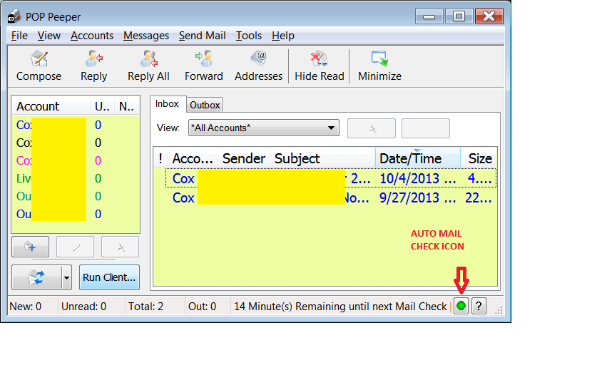

The simplest way to keep POP Peeper from checking any of your accounts is to click the icon with the green circle shown at the bottom right of the main interface. (See the screenshot shown below).
PP Global Mail Check icon
[Click image to enlarge]
After you click on it, the icon will turn red, and PP will no longer automatically perform a mail check of any accounts until you click on it again.
IMPORTANT NOTES:
(1) - Doing a manual mail check will not re-enable the Global Mail Check function. You will have to click on the icon again to re-enable it.
(2) - If you EXIT the POP Peeper program or reboot your computer & restart PP, the Global Mail Check icon WILL be re-enabled and show green.
Thus, you will need to disable the Global Mail Check function again.
Alternatively, you can also right-click the POP Peeper icon in your Taskbar Notification area, and click on "Autocheck" to remove the check-mark beside it. This accomplishes the same thing. To re-enable the function, just right-click the PP icon and click on "Autocheck" again.

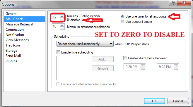

By going to "Tools" > "Options" > "Mail Check" from the main POP Peeper interface and changing the global "Polling Interval" setting to "0" you will have disabled the POP Peeper Mail Check that has the advantage of remaining sustained even if you exit POP Peeper or better yet when ever you might more commonly reboot your computer which is likely for most people (so in this case you will not have to recall every time you reboot to disable the Mail Check function using the more "simpler" methods previously mentioned :wink:). I would say that at least it's probably best for me as an older person because I tend to forgot things :D
Here is an illustration of what I mean in this screen-shot below:
THIS APPROACH WILL HOLD WHEN REBOOTING COMPUTER (click on image to enlarge - to then return to forum topic click on browser back-arrow)

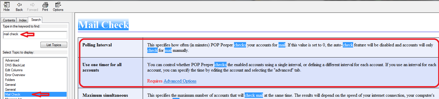

If you notice the setting states "0: disable", so setting this Polling Interval (minutes) to zero will disable the Mail Check under all circumstances. I would add however you do need to also make sure you have the "Use one timer for all accounts" enabled which will override any account specific Polling Interval settings in the event you have done this. Note: the account specific Polling Interval values that have been set (if you have done so) will remain set but will be disabled by this setting so if you want to go back to doing Mail Checks they way were were before that includes the Account specific Polling Interval settings then enable the alternate "Use account timers" option again. All of this is explained in the "Help" > "Contents" > "Search" function by entering "Mail Check" in the search box and clicking on "Mail Check" in the search results list (see screen-shot below).
CLICK on screen-shot TO ENLARGE TO IMPROVE READABILITY then click on the browser back-arrow to return to topic

At first, I thought lakrsrool was a mad genius for coming up with that creative solution but, alas, I tested it and it won't work. When you set the global polling interval to '0' you're completely disabling AutoCheck and assigning a separate polling interval to an account will not override this.
So, at this time, I think that the only solution would be to assign a "very high" polling interval to your spam accounts. Unfortunately, the highest value that you can assign in the GUI is 720 (12 hours), although I believe that this is only a GUI restriction and if you were to manually modify the ini file, you could set it to a higher value (note that it may or may not reset itself when you change settings in the GUI -- I don't think it does, but it's something you'll have to keep an eye on).
