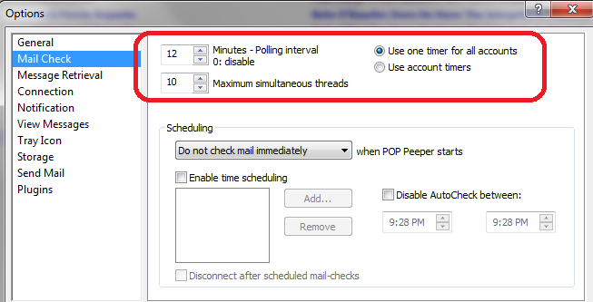

1) Please post the values you have in the circled area of the screen-shot below (under "Tools">"Options">"Mail Check"):

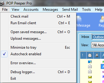

2) Do you have "Auto Check" enabled (checked) as illustrated in the screen-shot below (under "File" in main PP interface)
Auto Check enabled.png (24.14 KiB) Viewed 5464 times
