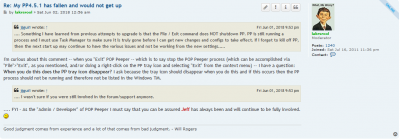

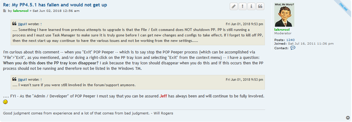

jjgui1 wrote: Sat Jun 02, 2018 12:53 am .... Something I have learned from previous attempts to upgrade is that the File / Exit command does NOT shutdown PP. PP is still running a process and I must use Task Manager to make sure it is truly gone before I can get new changes and configs to take effect. If I forget to kill off PP, then the next start up may continue to have the various issues and not be working from the new settings.....
I'm curious about this comment -- when you "Exit" POP Peeper -- which is to say stop the POP Peeper process (which can be accomplished via "File">"Exit", as you mentioned, and/or doing a right-click on the PP tray icon and selecting "Exit" from the context menu) -- I have a question: When you do this does the PP tray icon disappear? I ask because the tray icon should disappear when you do this and if this occurs then the PP process should not be running and therefore not be listed in the Windows TM.
jjgui1 wrote: Sat Jun 02, 2018 12:53 am.... I wasn't sure if you were still involved in the forum/support anymore.
.... FYI - As the "Admin / Developer" of POP Peeper I must say that you can be assured Jeff has always been and will continue to be fully involved. :wink:
