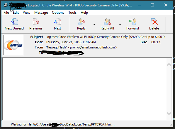

Experiencing a problem with Newegg Flash newsletters, opening them in preview window freezes pop peeper main window for about 5 minutes. Preview window contains no email content when shown, but can be resized and closed.
See attached screenshot:
Newegg Flash newsletters freezes pop peeper main window for approx 5 minutes

Re: Newegg Flash newsletters freezes pop peeper main window for approx 5 minutes
Can you send me a sample email; preferably send it as an attachment via email to (support at esumsoft dot com). Please send the original message source and not a forward -- view the message in POP Peeper and select File / Save message as.

The problem has been found and fixed. This is actually a variant of a known issue that has been addressed before. Unfortunately, there's no known work-around that you can apply immediately, so you'll have to wait until the fix is released in v5. Beta testing availability should be announced soon, though.
Also, I don't know if your "5 minutes" was an exaggeration but I would like to know, mostly for curiosity. On my computer, it was closer to 20 seconds.
In the HTML <head>, they're using a relative URL for an external script, like this: src="//(domain)". This is fine when you're viewing a message online with an existing point of reference (e.g. https://mail.google.com/), but when you're viewing the message locally, there is no base href defined; and, unfortunately, MS never fixed this problem in IE and so it causes a temporary hang (most modern browsers can handle it as I tested it in Edge/Firefox/Chrome). POP Peeper addresses this by injecting a base href tag; but in this case, it comes after the undefined protocol and so you still get the hang.
