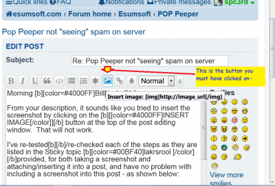

In the interim...to address the problem with including a screenshot into your post, please continue reading below.
From your description, it sounds like you tried to insert the screenshot by clicking on the [INSERT IMAGE] button at the top of the post editing window - as shown in the following screenshot:
Post editing window showing the INSERT IMAGE button
(Click image to enlarge it)
The [INSERT IMAGE] button is used to attach/insert an image from an external source (other than your computer), such as, Dropbox.

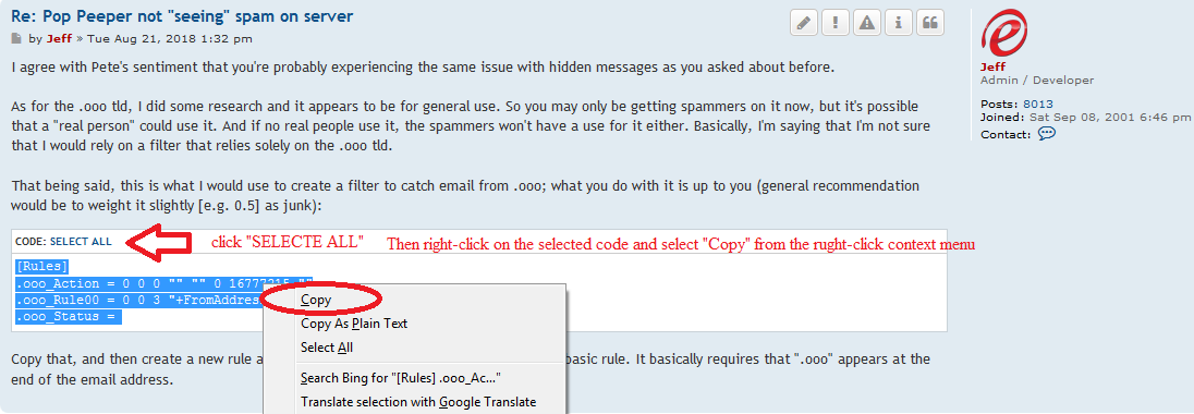

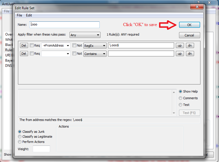

First thing -- After you copy the "rule set" that Jeff provided by doing the following (note: after selecting all of the rule set you can always press the "CTRL"+"C" keys at the same time to copy the selected rule set [to the clipboard] as an alternative to using the "right-click" context menu to copy -- to later paste the copied rule set):
Click to enlarge (to return to topic click browser back one page)
I think these are the steps that Jeff is talking about to create your new Junk rule set (refer to detail instructions under each screen-shot):

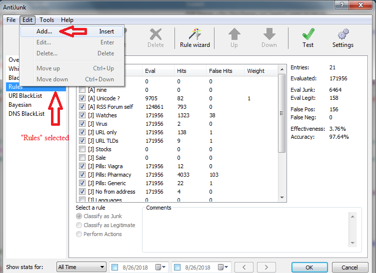

Step 1) First window:
Go to "Tools">"Junk">"Main interface..." and select (click on) "Rules" -- then as illustrated in the screen-shot click on "Edit" > "Add" to create the new rule.

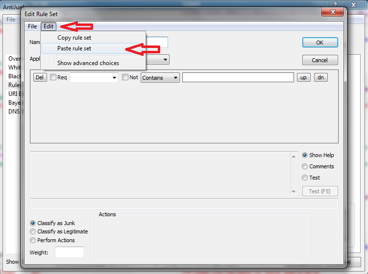

Step 2) Second window:
In the next window click on "Edit" > "Paste Rule Set" (to paste the rule that you had previously copied)
Step 3) Third window (results you must save):
You will see this window with the new rule created -- Be sure and Click on "OK" to save the rule.
You are done!

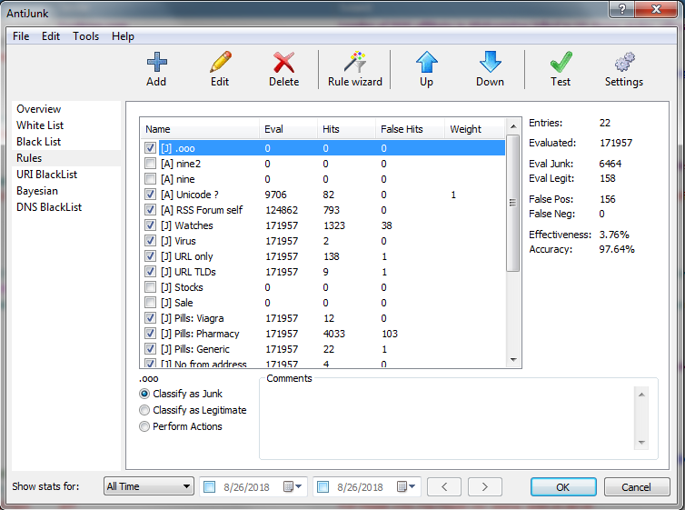

You will then see this -- your new rule!

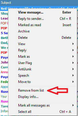

Note: You can test this rule (assuming the message has not been deleted) by returning to the PP main window and selecting one of these messages in the PP inbox that you want to be "Junk" based on this new Junk rule set (with this address - *.ooo) and right-click on that message and then select "Remove from list" (which will then remove the message from you PP inbox for the time being until the next Mail Check) -- then do a "Mail Check" (the message will then be retrieved again by PP) -- that message should now be classified as "Junk" (and any other new messages like this from now on as well).
right-clicking on a message and selecting "Remove from list" will temporarily remove message from PP inbox -- until the next Mail Check is done.
remove from list temporarily.png (11.12 KiB) Viewed 10785 times

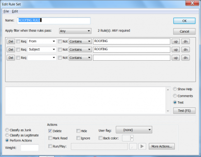

BDinger3 -- Your rule looks good.
btw, when you create a rule, you can use the built-in test functionality on the rule page itself, by selecting the "Test" radio button on the right-middle. Then put in just enough information to test it. In this case, I tested things like:
from: "some dude" <dude@somewhere.online>
from: "some dude" <dude@somewhere.online.com>
The first one should match, the second one should not.
You could also simplify that to:
from: dude@somewhere.online
but testing a "full" from value is probably better, as it will better ensure that you're using the correct fields (e.g. "+FromAddress" and not "+FromName")
