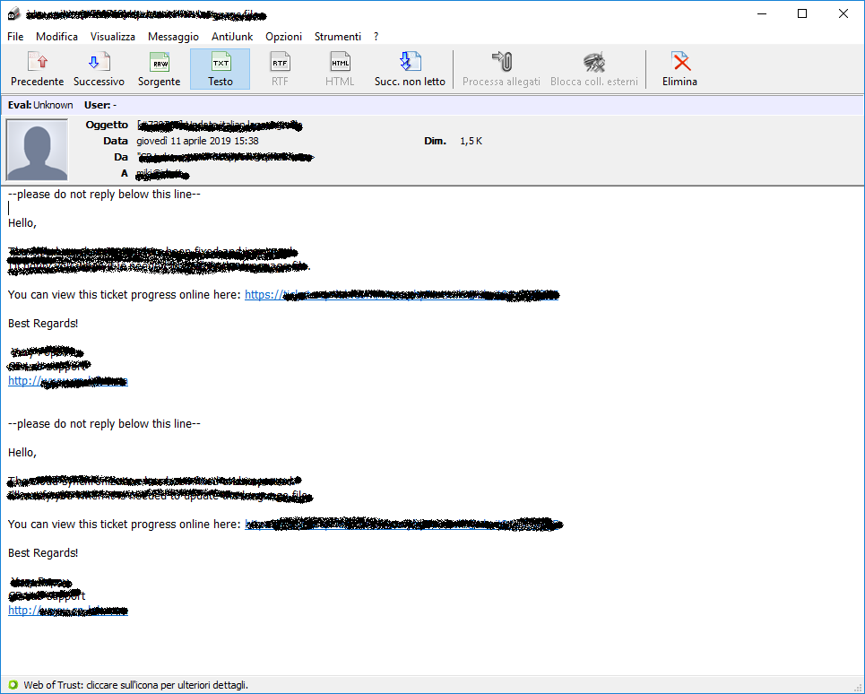

Good morning,
in some rare case the message body is duplicated in the viewer.
Here an example:
and here the message source:

NOTE: the messages with this problem are only when the Content-Type is "multipart/mixed"
I'm not sure if the problem is on the "eTicket" email formatting or in the PP viewer.

Posts: 9247
Re: body duplicated in viewer
Thanks for including the sample. I was able to duplicate the problem and it will be looked into.
Posts: 9247
I've just finished putting the final touches on this fix (and testing, as this could affect every message) and it will be in the next release -- whether that's v4.x or v5.0.
Thanks again for reporting this and including the sample.
