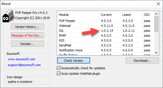

I followed your suggestion to update the SSL plugin but nothing has changed...
Now the installed version is 1.0.2.14 but the problem Error (authentication method is disabled." remains.

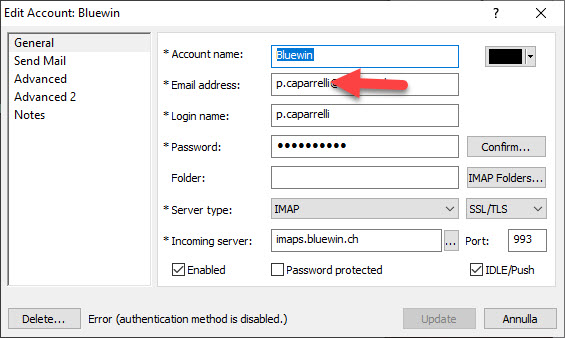

Also I tried to delete that account and reconfigure it (manually and importing from Outlook).

Sorry, I should have mentioned this, but we're handling this issue via email.
The issue is that the server claims to support cram-md5 when it actually doesn't. The proposed solution is to disable "secure authentication" under Edit account / Advanced 2.
