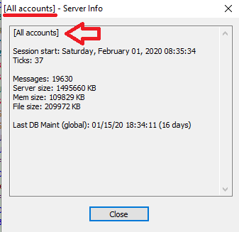

You will not get some of the options but the one we are interested in would be the "Server info (all)..." data. Keep in mind, if you don't right-click in an empty space the data will only apply to the account that gets selected and will not include the "(all)" reference in regards to the "Server Info" which is what we need --- so be sure that you get the "Server info (all)..." option listed in the list of right-click options. When you do then select (click on) the "Server info (all)..." option (which will generate the Server Info data for ALL accounts). Make sure what you get includes what is pointed out in this screen-shot below:
Server info for all accounts.png (7.44 KiB) Viewed 7441 times
Then copy that data (select the data inside the box, then right-click the selected data and "Copy") and post the copied data into this topic in your reply (right-click "Paste").

The "Server info" option is only available if you've enabled "Advanced options" under main menu: Tools / Options / General.

I activated the advanced options and here is what it said:
[All accounts]
Messages: 0
Server size: 0 KB
Mem size: 0 KB
File size: 0 KB
Last DB Maint (global): 12/07/19 10:47:55 (56 days)
