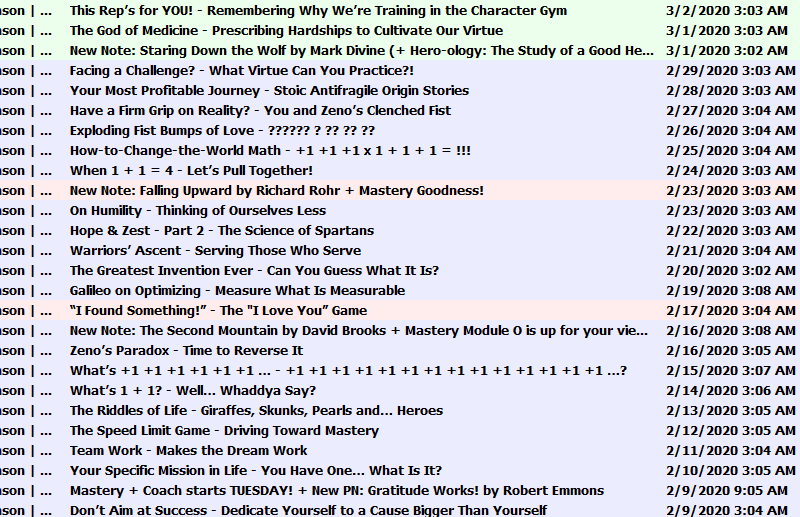

Thank you for your response. I switched my junk view to "Show All" and was again met with a sea of green in my email check. Out of the 100 or so different senders in this batch - most are newsletter or promotional emails, such as FTD Flowers, Groupon etc, I would estimate at least 80-90, which had previously been categorized in the "unknown" category are now categorized as legit.
Attached is a screenshot of a single sender. It shows the typical category identification, which is unknown, with an occasional junk identification, to suddenly in the last two days since this issue began, suddenly turning to green.

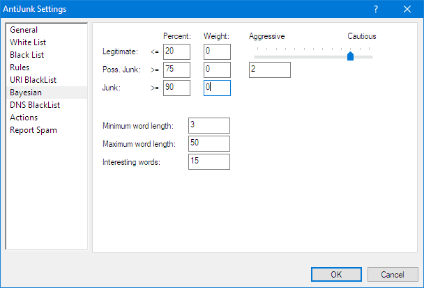

Based on what you're saying, it sounds like you would prefer that the Bayesian not be given any weight at all. So here's what you can do:
1) From POP Peeper's main menu, select Tools / AntiJunk -> Settings
2) Enable "Advanced settings" on the bottom-left of the right window
3) Select the "Bayesian" page on the left
4) Set the 3 values below the "weight" column to 0 (see screenshot below)
5) Press OK
To test that this worked as expected, right-click on one of your green messages and select AntiJunk -> Re-evaluate message.
If it worked as expected (blue/unknown), you can select multiple messages and then right-click one of the selected messages and AntiJunk -> Re-evaluate.
This will allow Bayesian to continue learning your messages as you train them in case you want to try out Bayesian again in the future. Another approach may be to leave the "Junk" weight at 1, so that Junk messages are still evaluated even if you have newsletters or such that you'd prefer to remain "unknown."
