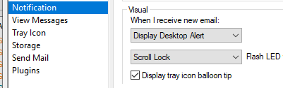

  1. I have these Visual notification settings:
    visual notification settings.png (5.17 KiB) Viewed 6516 times

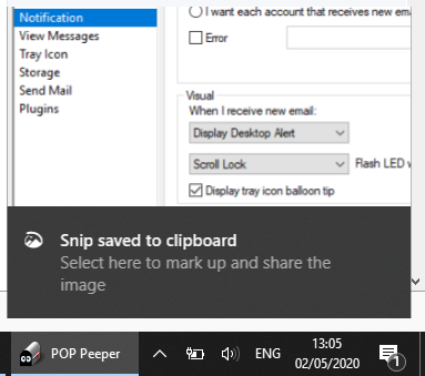

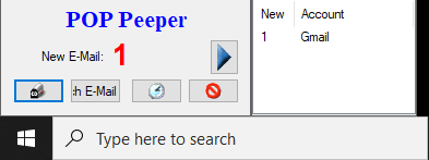

  4. The Desktop Alert pops up and Windows' notification counter is changed from blank to 1.
  5. I open PP's interface.
  6. Windows' notification counter remains at 1.
Compare this to Snip & Sketch. This internal Windows tool uses the built-in notification banners.
As result, clicking its banner both opens its interface and makes the counter go back from 1 to blank:

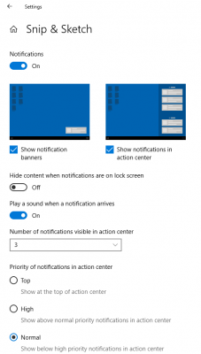

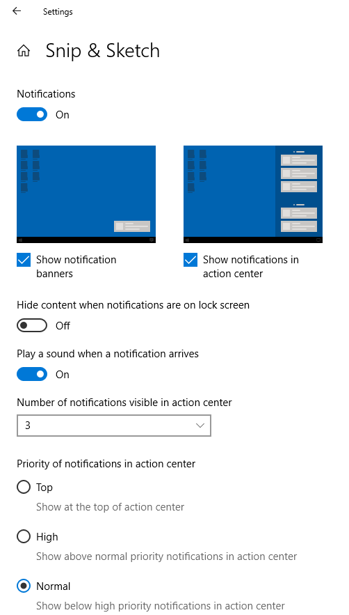

you can click the "manage notifications" at the top of the Action Center, find PP in the list, and disable the setting for "show notifications in the action center."
PP was the first in the list there! BTW, other than completely turn it off there are 2 lesser settings there: Show notification banners and Show notifications in action center. Turning off the latter means if you ignore the banner, it disappears after a few seconds and the counter goes back to blank. I'll try turning off this option for PP.

Ohh... I bet there's an important part of the puzzle missing. My Windows notifications stay up longer than normal, so when I open PP, the notification is still present. If I change the timeout back to 5 seconds... yep, if I let the notification timeout, and then open PP, the notification remains in the action center.
As for Snip&Sketch, if you look at its Action Center settings, it has disabled "show notifications in action center"

I never touched Snip's default and everything is enabled there except hide when locked.
Posts: 9444
Re: Removing Windows notifcations when opening the interface
Oh, well, it's very possible that I disabled the "action center" setting myself for Snip because its notifications would end up in there for me and I don't need it to. Regardless, that's the setting you'd want to use.
