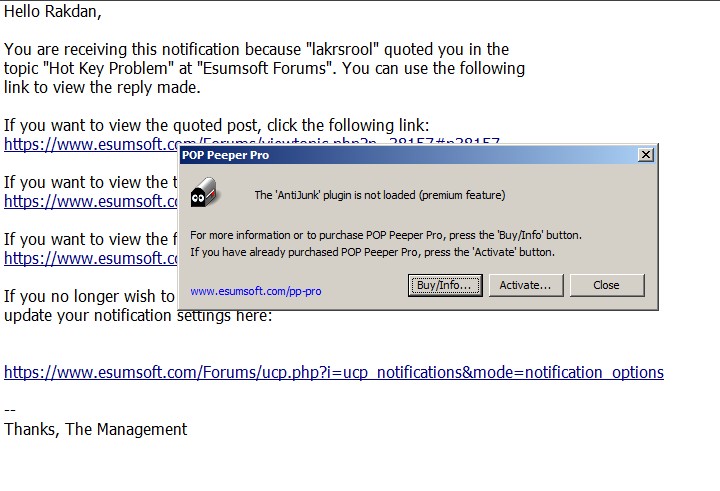

I just opened the email notifying me of the last post in this forum, and typed an L to get the screen shot below.
Re: Hot Key Problem
^ hmm, that is interesting... (and thank you for the clarification :wink:)
As I posted previously:
lakrsrool wrote: Mon Jul 13, 2020 10:07 pm As to the key "L" -- take note: There is a "Shortcut" Key default (not the same as "Hot Key") that uses the key "L" which is an "Anti-Junk" shortcut key to mark messages as "Legitimate" when your in the PP Read (message) Window. You can see this by selecting "Shortcuts" above the "Hotkeys" option in the same "PPtweaker" window.
The "L" key is used for "Anti-Junk". Which is why you are getting the message "The Anti-Junk Plugin is not Loaded" in the dialog box you've captured i your screen-shot -- which would mean just that. You do not have the Anti-Junk plugin installed.
As I mentioned -- Go to "Tools" > "PPTweaker..." and select "Shortcuts" (instead of "HotKeys") and then select "AntiJunk: Mark as Legit". You should see that the "L" key is set for this function (to mark messages as "Legitimate").
