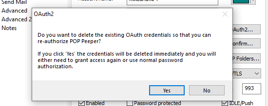

1) You will get a dialog asking if you want to delete existing OAuth credentials - you reply with "Yes" at this point

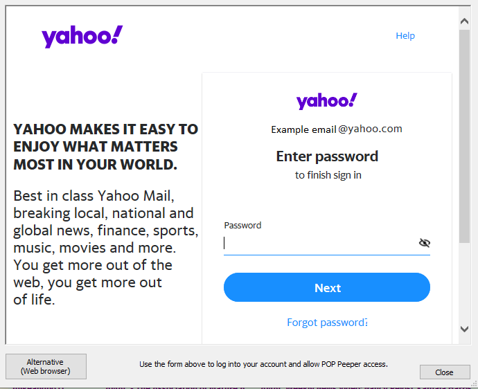

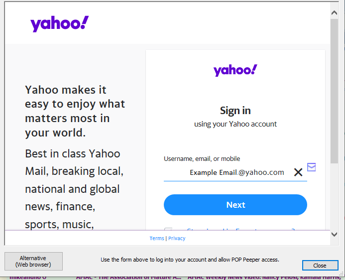

2) You will get UID and PWD prompts from Yahoo for the Email Account you have edited in PP and are authorizing to use PP to access the Yahoo Email account. You would reply accordingly.

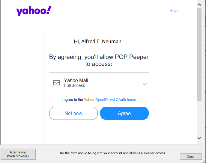

4) You should now get a dialog to "Allow" PP access to your Yahoo Email account.
5) Pressing Agree should complete the process

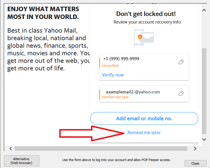

You may or may not get this next step
Recommend click on "Remind me later"

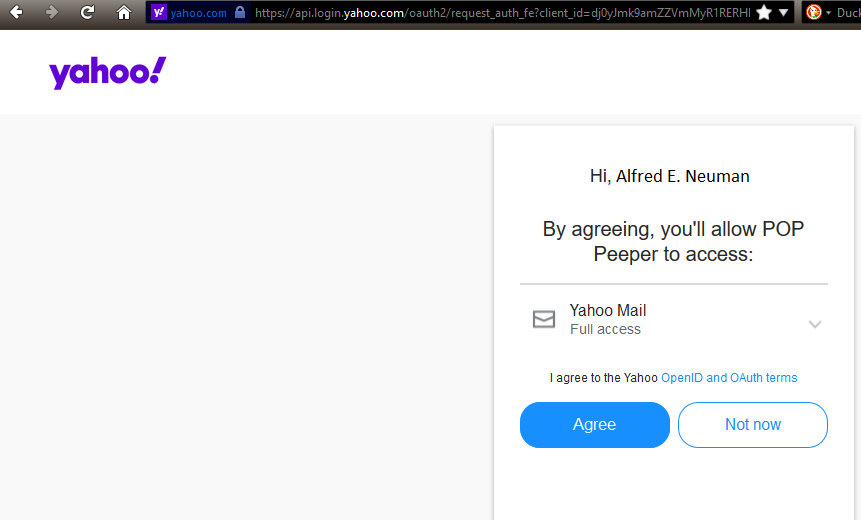

After clicking on the "Agree" button...
As mentioned previously, you should get the "Authorization Successful" dialog overlay at this point:

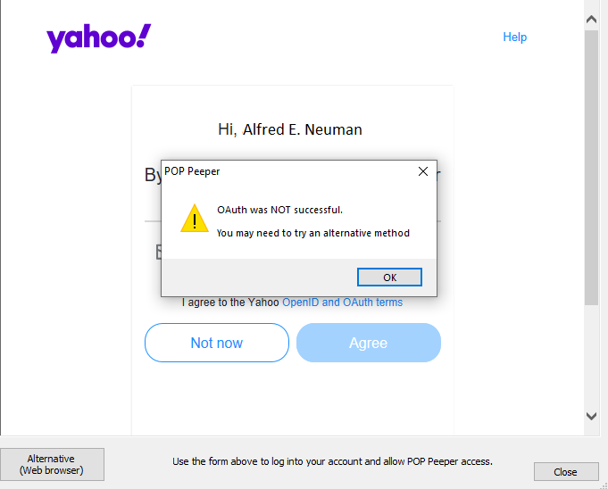

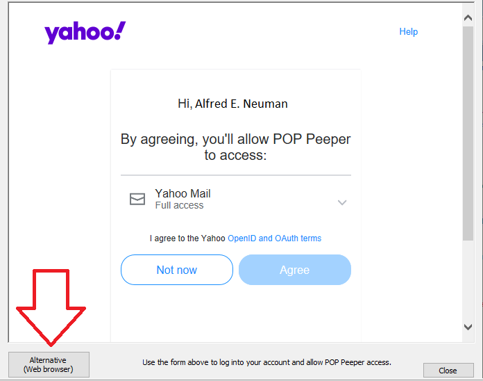

You may not if an issue occurs including possibilities such as:
Button "Agree" either does not complete (page hangs) or you may get an "unsuccessful" dialog
In any case you can use an alternative method to authorize PP (i.e. "Web browser" is one alternative):
Which will open the authorization dialog page in your browser (click on "Agree" and you're done):

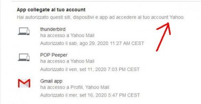

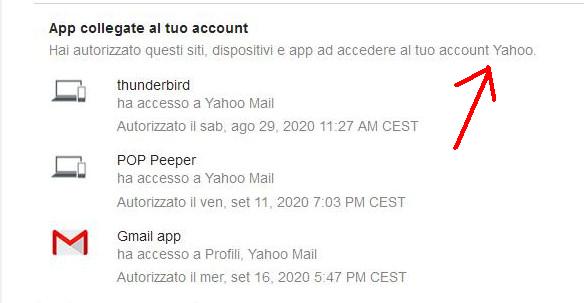

Check the apps linked to your Yahoo Mail account:
If you still receive the Yahoo email informing you that from 20 October the authentication will be exclusively OAuth2, it is certainly NOT the fault of Pop Peeper who has a perfect procedure.
I found that the email client app I used on my smartphone was malfunctioning for Yahoo Mail.
I replaced it with the Gmail app.
P.S. In the image above it is not Thunderbird that has access to the Yahoo account but MailNews (which is incorrectly recognized as Thunderbird).
