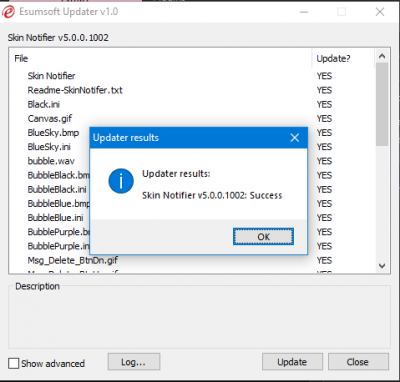

Re: v.5 upd: SSL Plugin not installed
For anybody that has a problem with auto-update suggesting that there's no update, could you please do the following:
When you get to the prompt in the auto-updater that says, "There were no updates specified" and the only option is to press OK
Hold down Ctrl+Shift while you press the OK button.
You won't get any indication that anything different happened, but at this point, open a text editor and use "Paste". Then, please also paste the results of that log in your reply (actually, I don't think it does, but this *may* contain personal information, so if you want to be safe, you may want to send me a PM or send it to me via email, support at esumsoft dot com).
Also, in order for me to try to duplicate, can you let me know if you guys have the Plus Pack and/or Pro ACTIVATED for v5? It's not necessary for either of these 2 plugins (and probably irrelevant during Pro Trial), but I just want to make sure I'm testing the same procedure.
I'm not able to duplicate the problem with the skin notifier or SSL using auto-update. Using the free version (and this is with Shareware already expired), here's the process I took (for tracking):
1) Installed Ppv5 to a new folder, deleted the SSL files and installed Skin Notifier v4.3
2) Created a new ini file
3) Went to Help / About and pressed "Check version"
4) It told me there was an update for Skin notifier so I went through the process successfully: 5) Next, I added a gmail account
6) Tried to check mail it and got the expected error that SSL wasn't installed
7) Pressed the link that the error prompt gave me to auto-update. It also went smoothly.
Ctrl + Shift
[20200910 13:46:14] Initializing: [dir: D:\No Install Startup Apps\POP Peeper] [packages: skin] [ver: ]
