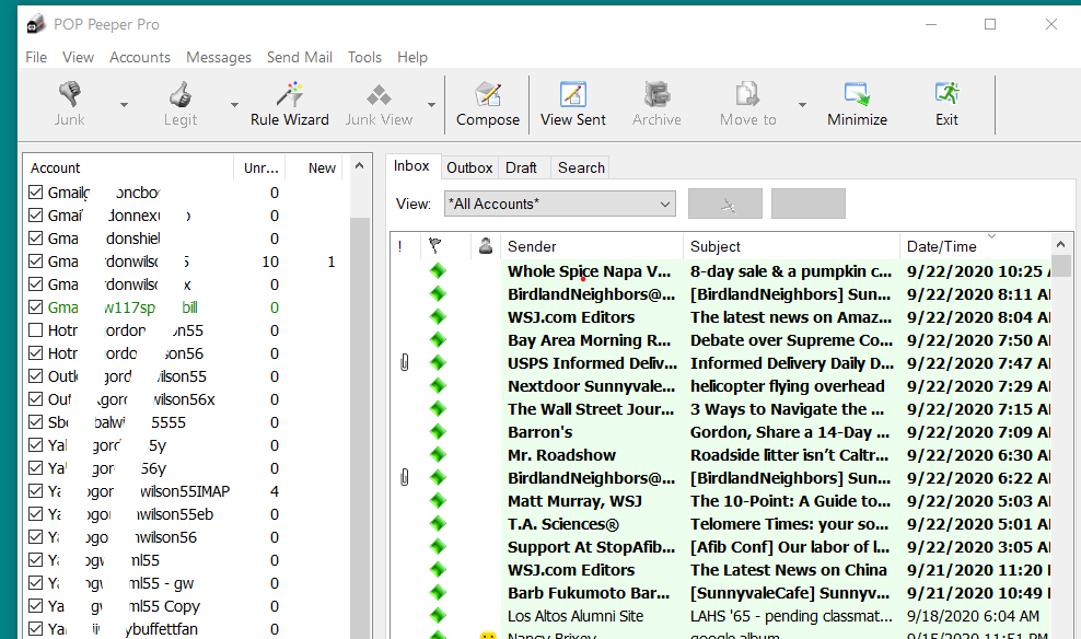

gordon
Posts: 208
Re: search box width
Post by gordon »
Posts: 9239
That's pretty modified. However, I did make a change -- the search box will shrink (minimum width: 35px, which is about the length of the displayed text "search") so it would be visible in that screenshot.
