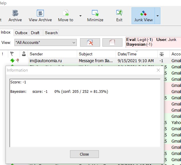

This message is colored red, but the evaluation says legit (-2.5)
Also, doesn't a thumb down flag cause an "Eval Junk", overriding everything?
This is a .ru junk mail.
There were 2 recipients on this mail.
Should multiple recipients activate a rule?

As far as the coloring is concerned: the thumbs down (meaning, you've deliberately specified it as junk) overrides the evaluation. After you mark the message as Junk, you could re-evaluate the message and it's very likely that it will be evaluated as Junk; but PP does not re-evaluate the message automatically after you mark it as Junk/Legit, so you're still seeing the original evaluation in your example. You can re-evaluate it by right-clicking and selecting AntiJunk -> Re-evaluate message (or under the main 'Messages/AntiJunk' menu, or under 'AntiJunk' when viewing the message).
Multiple recipients does not have any effect by default; multiple recipients is not uncommon for business, friends, family, etc.

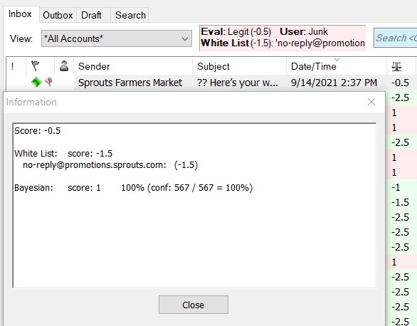

3) In the attached the evaluation column rectangle is green, but the Evaluation box
and message are red.
They should all be the same color, right?

gordon wrote: Fri Sep 17, 2021 2:24 pm 3) In the attached the evaluation column rectangle diamond is green, but the Evaluation box
No. The diamond represents how POP Peeper (aka "system") evaluated it -- it thought it was legit. The thumbs down represents how you evaluated it -- you said it was junk. As mentioned before, as far as coloring is concerned (and, by that, I mean the background coloring), the user's evaluation trumps the system's evaluation, so that's why it's colored red. The contrasting diamond color could be used to quickly see which messages are disputed and allow the user to investigate further if they want.
In this specific case, even re-evaluating the message won't matter because the (edit)Bayesian filter has already determined it was Junk. But, the email address is in your white list, which has more weight than Bayesian. I would say that it's a questionable tactic to mix how you mark messages from one sender. If you're signed up for a newsletter and there are particular types of email from that sender that you're not interested in, it's usually better to create a specific rule to delete those (or see if you can opt out of those specific types of email). There are probably other tactics you could try if it's for curiosity sake (change the weight of the white list to 1.0, or remove their address from your whitelist -- actually, maybe not removing because it could be re-added to a white/black list when you mark it, so maybe change the weight for that specific email address to 0.0... ah, you can't do that because it thinks you want to use default in that case, so maybe 0.1 [lower values are quirky and may or may not work, added to my notes]).
