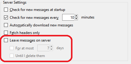

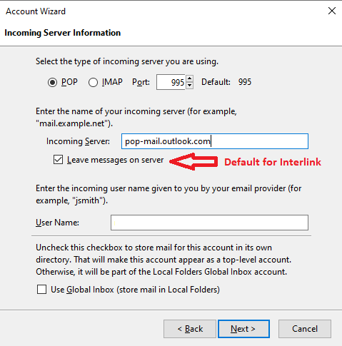

Can't say for sure about TB - but, FWIW, what I get in my Email Client (Interlink) that is in many ways very similar to TB depends upon the Email Service that is used i.e. Gmail appears to perform different than say Outlook.com or Yahoo.com etc.
For the latter accounts (Outlook, Yahoo) -- if (when initially setting up an account) I do not leave the (default) check for "Leave messages on server" in my Email Client then the message(s) will be removed from the server as of the next specific Accounts Mail Check by the Email Client:
Once an account is setup there are alternate options as such that can modify this that perform accordingly (i.e. if "Until I delete them" is enabled then the message(s) will be deleted from the Gmail Server on the next Mail Check by the Email Client for the corresponding account):

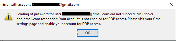

Firstly, in regards to Gmail using "POP", for my Email Client it is required to set the Gmail account to use "POP":
and if I do not do this I get the following error in the Email Client:
Error message if POP is disabled in Gmail account.png (7.49 KiB) Viewed 9487 times

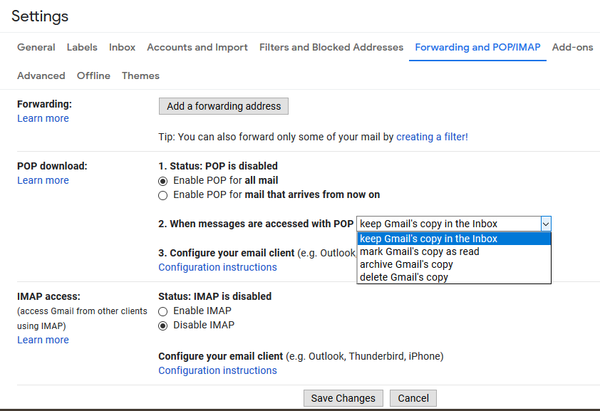

In as much as the Gmail "POP" setting is required for my Email Client in order to use "POP" - I find that the "POP" settings in Gmail (regarding how messages are retained on the Gmail Server) supersedes any of the Email Client settings in this regard that may be in conflict with the Gmail "POP" settings. Other than that, whether or not messages will remain on the Gmails Server will be reflected by what the Gmail settings for "POP" are set at (as illustrated in the 3rd screen-shot). Presumably, if there are no conflicts between the Gmail Settings and the Email Client settings, I would presume the Email Client settings would apply (equally).
So in my case, with the caveat that it will depend upon what settings are applied, it would appear I get similar results to what Jeff has described in his post above as to what occurs on an Email Server when using "POP".
