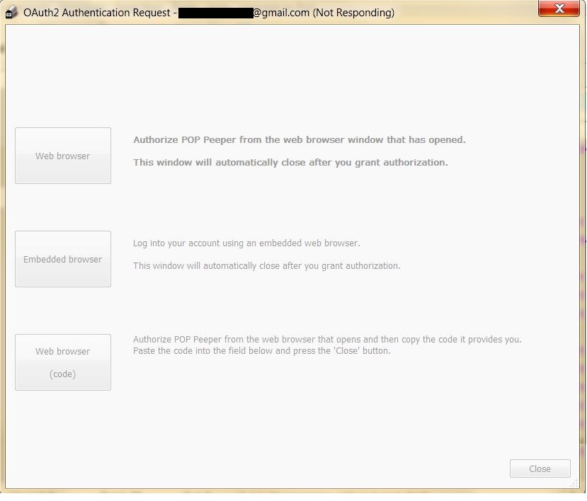

Post by bbqbrisket »
I keep trying to reset this with the Oauth2 but it's not working.
The popup menu keeps hanging up whether I choose one of the options or choose nothing.

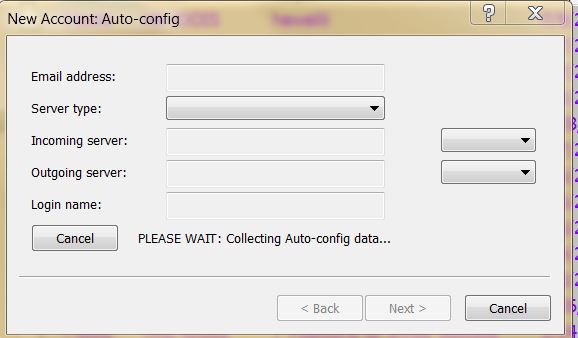

After deleting the account and trying to add it back in again as new, I get another hangup screen.

I checked it with Pop Peeper v5.4.1, and it works fine for me.
For me, it looks like, your Pop Peeper.exe cannot access to your internet connection. Did you check this?
(You can check this with menu Help -> About -> Check version.)
Re: Gmail Oauth2
bbqbrisket - have you recently added or changed any security settings of any kind on your computer (i.e. Virus protection and/or Firewall etc.)?
If so, try looking into this.
If not, have you tried rebooting your computer?
Re: Gmail Oauth2

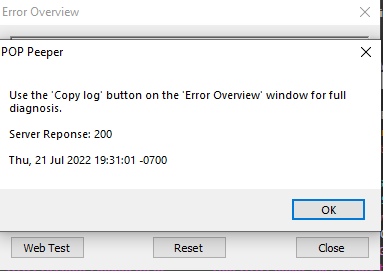

Yep, previous posts nailed it -- firewall would be my first guess; both Oauth2 and account auto-config will request data from 3rd party websites via https.
However, a better test in POP Peeper to make sure your firewall is configured is:
main menu: File / Error overview -> Web Test
Server response should be 200 and the data should be a current timestamp (PDT)

Re: Gmail Oauth2
Did you try the test Jeff suggested to do?
What I get:
The results are good for me as I get the Server response 200 and the time is accurate in my case
web test for me.png (6.58 KiB) Viewed 7865 times
The fact that you are not having any issues with MS accounts however makes me think that this test will likely produce good results for you.

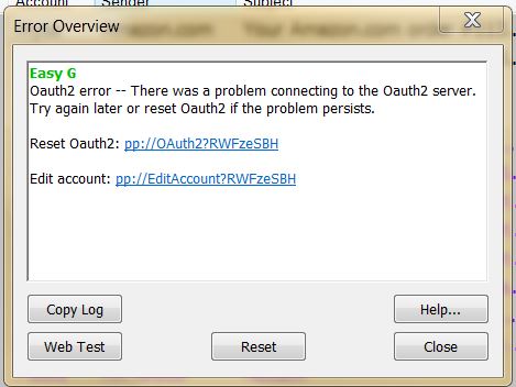

bbqbrisket wrote: Thu Jul 21, 2022 6:04 pm ... Sometimes it will give the Error message....
What "Error message" are you getting? (I don't recall you mentioning this before)
If you get this error message again - please capture and post into this topic (removing any personal information to protect your privacy). Please, do whatever it is that produces this "Error message" you've now mentioned and then capture it and post in this topic.

Have not tried the test yet but here's the error msg.
Re: Gmail Oauth2
You'll need to email me (support at esumsoft dot com) so we can see more details about the problem.
