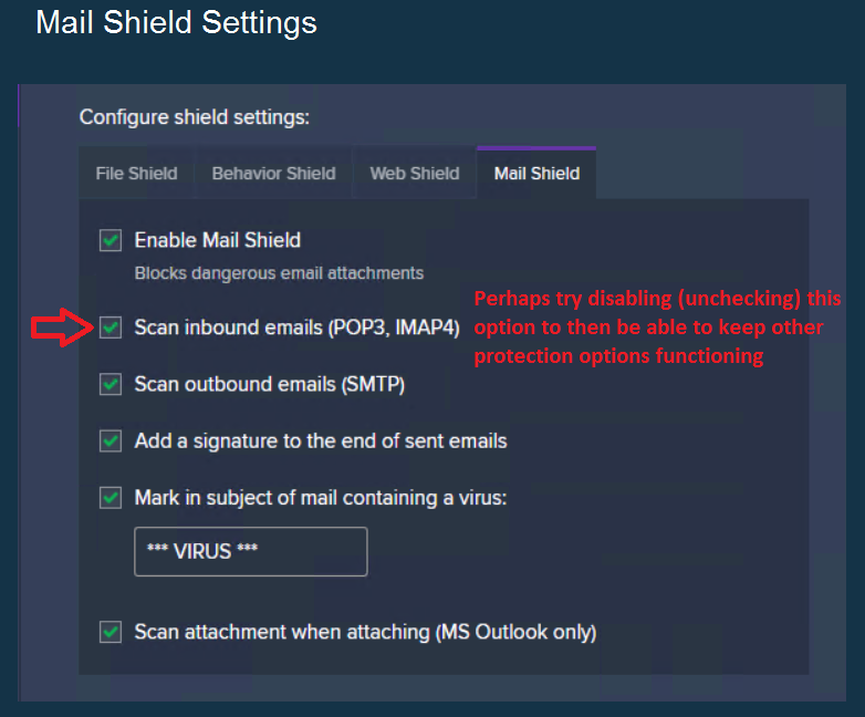

Posts: 2261
Re: After last Avast update POP Peeper (4.5.3) stop to work!
Good to hear POP Peeper is working again =D>
You may not want to bother with this (the Avast "Mail Shield" can be troublesome and difficult to work with).
That said, you could try disabling some of the "Mail Shield" options that cause the issues you were having and perhaps still keep some of the other protection the Avast "Mail Shield" offers:
Disable (uncheck) the option pointed out above may be enough to avoid the issue with POP Peeper
I wouldn't take too much time on this if trying other options doesn't help in the end (the last time I used Avast, well over 4 years ago, I don't recall any ability to set "exceptions" in the "Mail Shield" so this may be the limit to which you can test to see if it is possible to leave some of the "Mail Shield" protection at your disposal).
You can always go back to disabling the entire "Mail Shield" if problems arise with POP Peeper as a result of trying various options.
