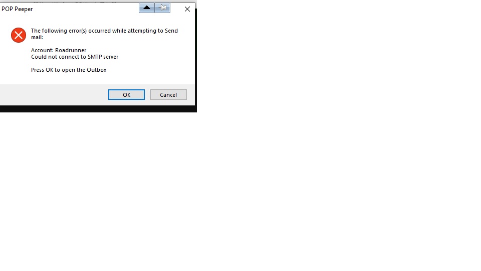

I can' send any email from my roadrunner account, I have checked all settings
and have talked to tech support from spectrum but according to there settings
I have every thing OK. I can send from other accounts to RR but not from RR.
Any suggestions would be appreciated. I can go to there web site and send
mail but that not what I want to do all the time.

What is the error you are getting in POP Peeper (please post in this topic) when attempting to send mail (SMTP)?
Please post your POP Peeper "Send Mail" settings.
Presumably they are:
SMTP Server: mail.twc.com
SMTP Port: 587 SSL/TLS
Server requires authentication is checked.

you have settings correct, sorry I didn't include

Posts: 9251
Re: can't send email from TWC account
I didn't notice this before -- I'm not sure where mjs got those server settings from, but if you confirmed that with yours -- it's not quite accurate.
Port 587 goes with STARTTLS; SSL/TLS goes with port 465. You should only change the SSL option to whichever and POP Peeper will adjust the port accordingly.
I don't have twc in my state, so I'm not too familiar with its history, but I assume its current owner is spectrum? According to this:
https://www.spectrum.net/support/intern ... mail-setup
they state port 587 which means that you should be using STARTTLS and not SSL/TLS (for SMTP). (ftr, that is quite possibly the worst table of email settings I've ever seen: "port 993; port 587" without clarifying that the first port is for imap and the second port is for smtp)
Conclusion: Change smtp SSL settings to 'STARTTLS' (port 587)
If you still get an error, please include the full error provided by POP Peeper: press the "Copy Log" button from the error window (press the yellow '!' button in the status bar [bottom-right of main window]) and paste that (text) into your reply.
