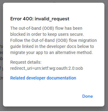

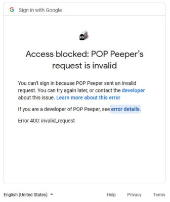

I am trying to setup OAuth2 with a gmail account and I am getting the following errors.
Re: GMail OAuth2 issue

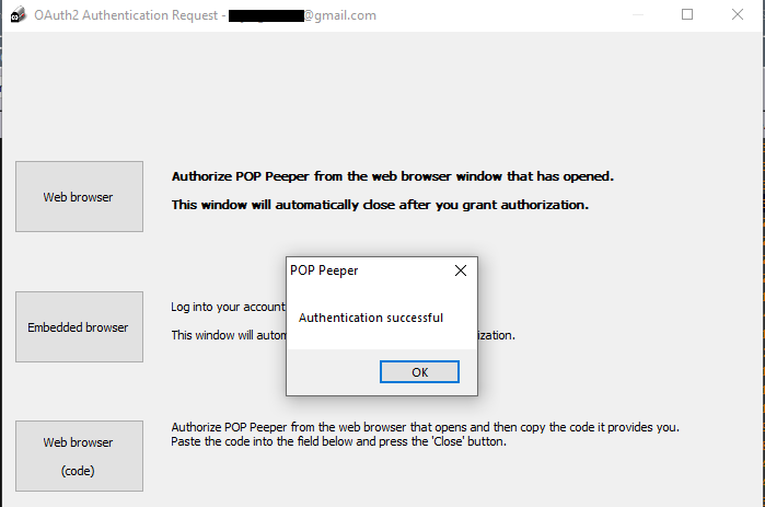

Could some security software be interfering (that you have added or changed recently)?

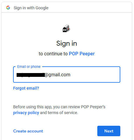

I have stepped through the entire Oauth2 process successfully on one of my Gmail Accts.
Step-1
Step-1

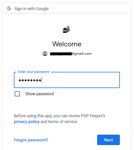

Step-2
Step-2

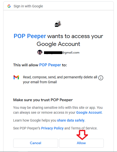

Step-3
Step-3

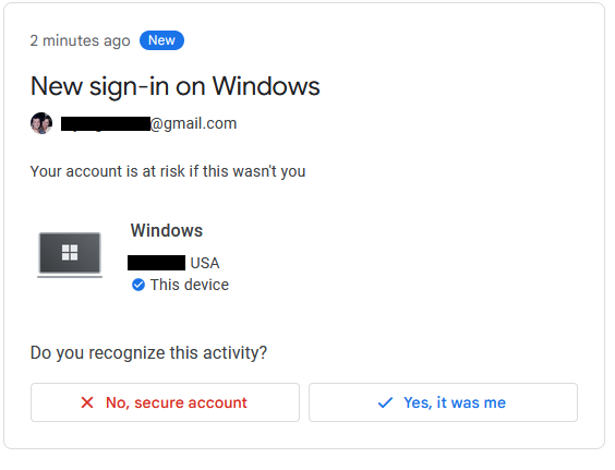

Step-4 - successful Oauth2
Aside of the above, just curious, are you getting a similar 'allow' ("Yes, it was me") confirmation 'activity' message from Gmail (in the Inbox of your respective Gmail account)?
Are you getting this confirmation message from Gmail?

There are 2 parts to this:
1) You must be using POP Peeper v5 (PPv4 used the OOB method that Gmail has deprecated)
2) You must be using a recent version of Windows (Win10 is sufficient; Win7 is not; Win8 is questionable)
OR run POP Peeper as Admin, but I don't necessarily recommend that (although it may only be necessary to run as Admin when you need to Authenticate with the webbrowser).
If you have Win7, then I recommend the use the "App password" method:
https://support.google.com/accounts/answer/185833?hl=en
If you really want/need to avoid using 2FA, then you can try the run as admin technique (still requires PPv5).
reference: https://www.esumsoft.com/news/notice-gm ... peeper-v4/
