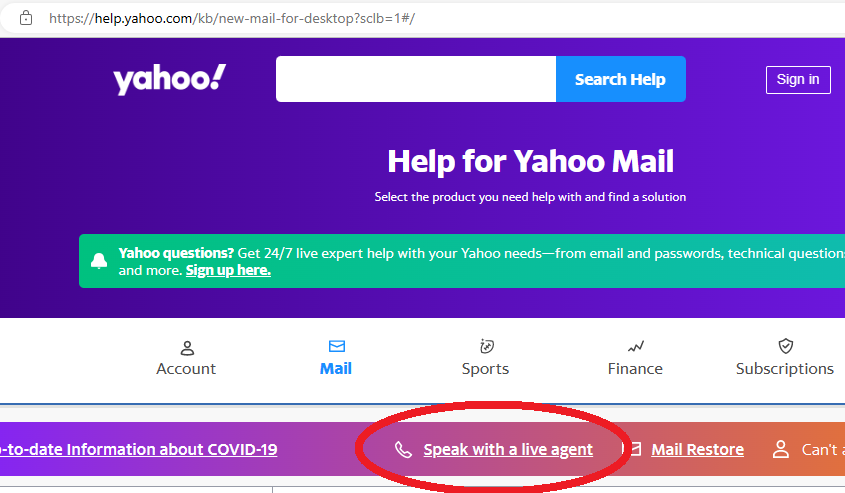

Re: missing headers
Have you tried this site to get Yahoo help: https://io.help.yahoo.com/contact/index?page=home.
There's an option (link) to "speak with a live agent" for FWIW.
No telling what "wait" times will be... Ugh!
Posts: 9251
Re: missing headers
I had found that -- it requires a premium service. And this is not something that I would want to try to explain to a level 1 tech rep.
