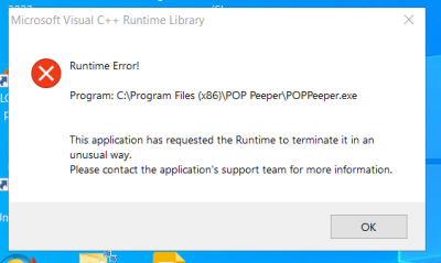

I have POP Peeper v5.4.5.0 running on Windows 10 Pro 22H2 up to date with Windows Update.
At random times (maybe 1 or 2 times per week) POP Peeper terminates with a C++ Runtime Error popup.
This has been happening for the previous 2 or 3 months.

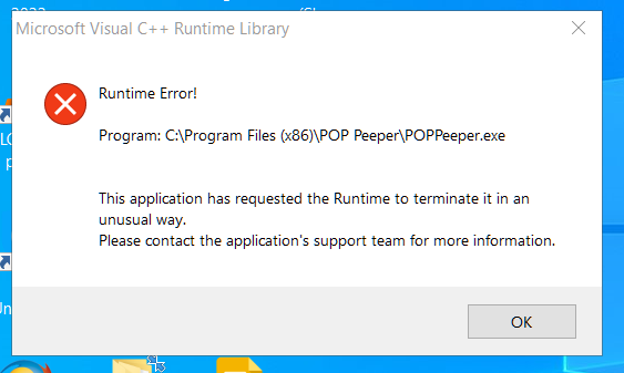

After working correctly for several days, POPpeeper will show this message on my desktop.
I can still open POPpeeper with the above error showing on the desktop and it works normally although it is not downloading any new messages.

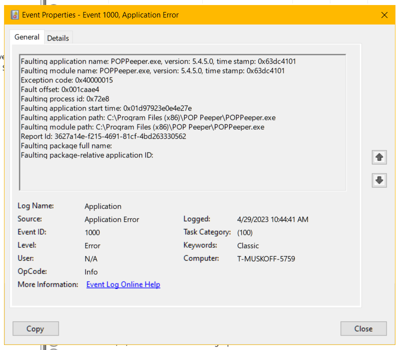

The event log does not register a problem until I click the "OK" button (above) which causes POPpeeper to end execution and then this log entry appears...
I start POPpeeper again and all is well until the next time.
The next message that arrived after restarting is from Gmail but is noting unusual in content.
Can you help me diagnose this problem?
