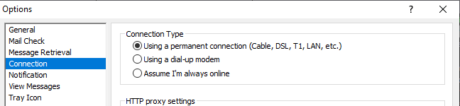

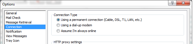

What is your "Connection Type" setting under (main menu) - Tools/Options/Connection.
My setting
My setting

efremk1
Posts: 12
Joined: Fri Mar 17, 2023 11:17 am
Re: recent, delay on gmail message retrieval?
Post by efremk1 »
Thanks. It has not changed in years.
