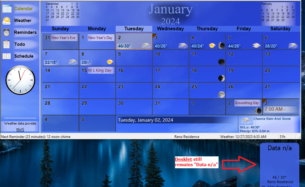

Just an FYI - It still hasn't appeared to be working for me at any time up till now:
Still same as it has been for a few days
I've exited/restarted Aeris Calendar well over an hour ago (after the comment posted above).
Hmm, I guess you're talking about the "daily" forecast displayed in the Calendar (not the Desklet, per say)... :-k (after all you did say "forecasting" started working as of 1-1-24 :idea:)
So presumably the Desklet - will start working as well, when everything flushes out at some point. 8)

Re: Weather not updating
What do I need to do to get my Desklet to work? - at this time (post time) I've still got what I previously posted for the Desklet (tried once again exiting/starting Aeris).

What do the timestamp and time since last update on the lower-right of the main interface show?
timestamp and 'time since last update' data
time-stamp and time since.png (1.2 KiB) Viewed 77070 times
Obvious problem here (8/20/23 3:50 PM and 3259h).
I've exited/restarted Aeris a number of times over the past days. (btw, the values here makes me wonder how Aeris has been providing temps for me at all in the Desklet or other wise (my issue, like anyone else, has been over just the past 5-6 days where Aeris has had issues as reported here in this topic)

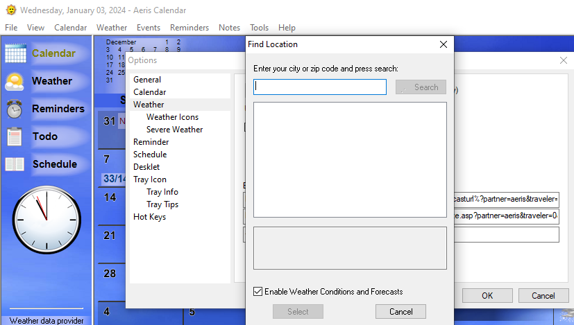

Also my location setting is empty and if I navigate through the process to set a location, the location selected (entered) does not hold (if this matters) - ends up blank again as illustrated in the screen-shot. (Note: the "Location" [text] does display toward bottom of Desklet [as illustrated in my previous screen-shot posted earlier] - so I assumed no issue there all this time)
What I'm thinking as a contemplate the "location" setting is that this is expected to be blank as the prompt is to set a (new) different location, thus my location is set actually (I'll have to see if I can determine where this can be confirmed if possible however).
I say this because for one thing the setting "name" does change based on what I've entered in the "Location" settings - so it appears to be present based on what I observe the Desktlet is rendering on my desktop. Hence, I'm assuming actually no issues there - the blank value is just somewhat misleading (confusing) I'd say....

"Set Location" is expected to be empty when you open it.
Try using a different location (e.g. New York or Los Angeles) and see if weather works for that location. Assuming it does, try a location *near* you but not the same.
Yea that's what I mentioned just above your post in regards to the "empty" Set Location (and I do see the changes referenced in the Desklet) - so then where can the "Location" be "confirmed" in Aeris (since it's not available in the "Location" settings procedure)?

I'm focusing on the "timestamp" and "time since last update" which has now changed to:
12/27/23 6:33 AM 75h
Still doesn't seem right to me - shouldn't it be reflecting current date/time data?
