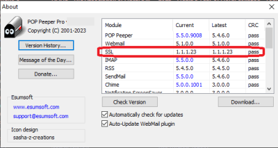

Check out "About POP Peeper..." (from main menu go to Help/About POP Peeper) and take a look at your SSL Module info (see screen-shot below) to determine if what you see is the same as in the screen-shot I've posted:
(if what you have is not the same, then please post a screen-shot of what you have)

If you see the same then you should be fine.
