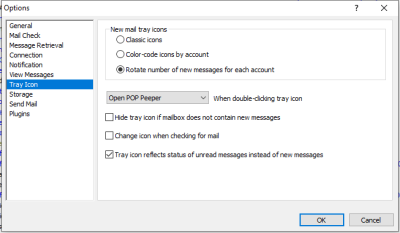

P.S.: I restarted PP and i noticed that in the icon tooltip the 5" startup delay was mentioned but after those 5" passed, nothing. Perhaps this is due to the fact that i have about 20 accounts, each one with its own timer ("Use account timers" selected in options)...
P.S.2: Also, check the attached image, the options may play some role.
Posts: 9433
Re: Poppeeper disabled after turning on PC from sleep
Thanks for including that screenshot, I suspected you may have disabled the "change icon when checking for mail" (reason below), but wouldn't have guessed "tray icon reflects unread instead of new" -- these could all be potential factors for your original issue, as you mentioned.
As for the reason you mentioned the "time remaining" status disappeared -- it does this when it's actively checking an account; this is more apparent with the animated icon checking for mail. After PP has finished checking any accounts, the tray icon status should display the time remaining again (to clarify: the tooltip won't auto-update if you just keep hovering the mouse, you need to move the mouse off to dismiss the tooltip and on again to re-display the tooltip).
