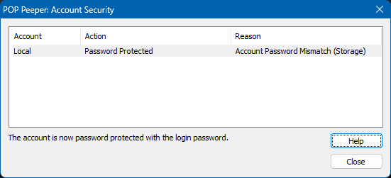

Thanks for reporting this, it is a bug in v5.5.
When you start POP Peeper, you will see a prompt like this:
Notice on the bottom that it says:
"The account is now password protected with the login password"
You should try to edit the account and when prompted for the password, enter the login password for the account (or, specifically, the last login password entered into POP Peeper [e.g. in the case of using Oauth2]). Once you can access the account, you should disable "password protected" and then re-enable it if you want to re-enter your password.
[edit] If you don't change/cycle the password protected option, you will keep getting the same prompt and problem after restarting POP Peeper.
